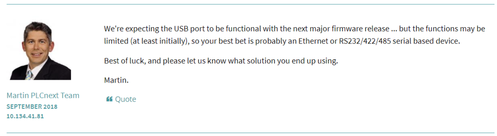

I saw another forum post where an expert of Phoenix Contact said there is the intentention of making it possible to use the USB-C as a tty/(virtual com) interface at the end of 2022. This would leverage the abilities of the device even more. For example connecting a barcode scanner that is programmed to interface over serial (ascii), or even connecting to an arduino ;)

I don't have a record of what I was told in 2018 that informed my expectation back then, but unfortunately that feature was never implemented and it is not currently scheduled.
Please check the "Development roadmaps" page of the Info Center occasionally, and if/when this feature is scheduled it should appear there.
In any case, connecting a barcode scanner probably will not be possible, since the controller will be a USB device, and not a USB controller.
