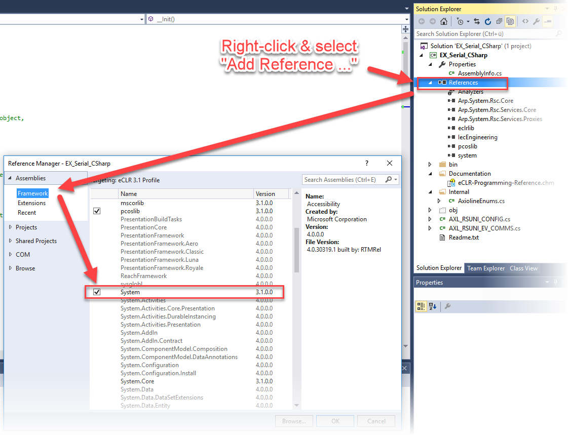

    Hi Rob,
     The solution is to add a Reference to the "System" assembly to your C# project, as shown below.
    I'll see if we can get this important step added to our How To guide.

  • I have one addition to the answer of Martin. Make sure to use only references from Phoenix Contact or build for your target eCLR Profile. .NET References do not work. All available namespaces provided by Phoenix Contact can be found in each project created for PLCnext with Visual Studio in the file Documentation/eCLR-Programming-Reference.chm.
    @Rob H: Your issue is a combination of issues. Starting with Visual Studio 2017 we where not able to add System.dll as a default reference. You have to add the "System" reference for your eCLR Profile manually and this contains all available namespaces you are missing.
