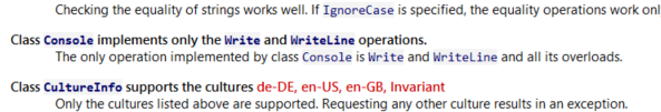

I'm aware of the log class but having Console output allow to use and test piece of code on other target.
In Eclr programming guide it is written than console ouput is supported.
So what is the purpose of console class.
