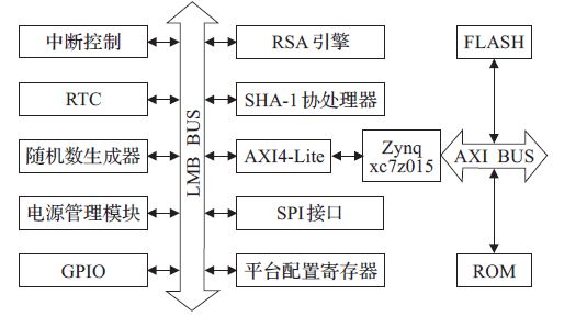

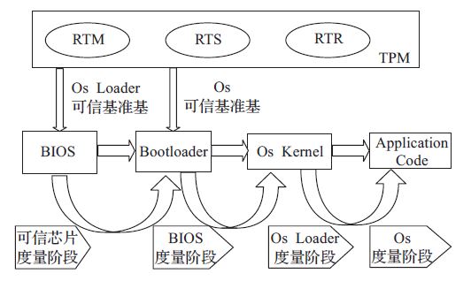

Hello Martin Thank you for your information! However, there are several topics we care about: 1.the general description about the architecture design of PLCnext TPM ,does it based on a FPGA? or other ways? Maybe like the attchment picture show. 2.about TPM function, does it just we claim it to customer, or is there a so-called third party inspection agency certification to make customer accept? 3.to some primary users, how we can do simple test ,for example , the same operation to PLCnext and classical PLC to show the different effect between with TPM and without TPM ? Just discuss, I’m sorry if offended you. Looking forward to your reply!

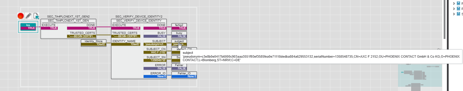

In the Application Program, programmers can use this information to check if they are running on a PLCnext Control device, or even on a specific device, by checking the serial number. The PLCnext Engineer function blockSEC_VERIFY_DEVICE_IDENTITYoffers a check of the Device Identity. In this way, it is possible to guarantee that the user program is executing on a specific device family, or even on one unique device.==================== Please let us know if you have any other questions. ~ Martin.

[quote]In the future, do you plan to make the Root cert publicly available? [/quote]No, this root is for Phoenix Contact only. Customers must install their own certificates with web-based management (WBM) to the identity/trust store, or copy them as files. If OPC UA is used and a Global Discovery Server (GDS) is available, then your own certificates can be provided to the device via GDS. [quote]What information is present in the devices certificate that we can use to validate inventory? Is the PLCnext devices serial number encoded in the certificate somewhere for example?[/quote]We provide an interface that can be used to retrieve information like this. Besides the Device Name “Subject_CN” and the serial number “Subject_SN”, the full subject is provided as a string. The idea is to let the application check if is running on the correct device. If not, the application might close itself and/or take other actions. You can use PLCnext Engineer function blocks (below) or the Device Identity Validator Service in C++ code. [attachment]security_fbs.png[/attachment] [quote]As developers on the PLCnext device… do we have the ability to interact with the TPM and use it to sign?[/quote]Its technically possible to generate a new private/public key from the TPM and use it on a PLCnext Control device. To proceed with this, you will need to get in touch with the technical support people in the Phoenix Contact office in your country, via your sales person. Or, with your permission, we can give them your contact details. This is not a common request, and it’s better if we do this via direct contact. (ref: #217134)
