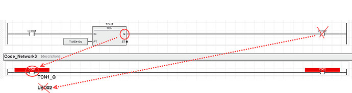

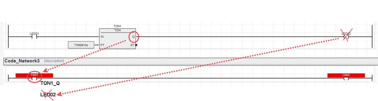

Hi Martin, Thanks for your reply. It seems I haven’t explained myself very well. I am pleased with your explanation as it is a pearl of wisdom I can use later. What I’d like to do is TAG an open contact (C001) with the output Q of a timer block, preferably without having to use a COIL(LED02) connected to that timer output block. (See attached)

Oh, I see, sorry for the long, unrelated answer. :slight_smile: Is this what you mean? 2020 12 16 16 29 47 (the relevant tag is TON1.Q , or more generally “Instance name” dot “parameter name”)
YES! That’s it! “Instance name” dot “parameter name”… Of course says me as I’m smackin the side of my head… :slight_smile: Thanks Martin! BTW…I’m having lots of fun playing with the kit. Ted
