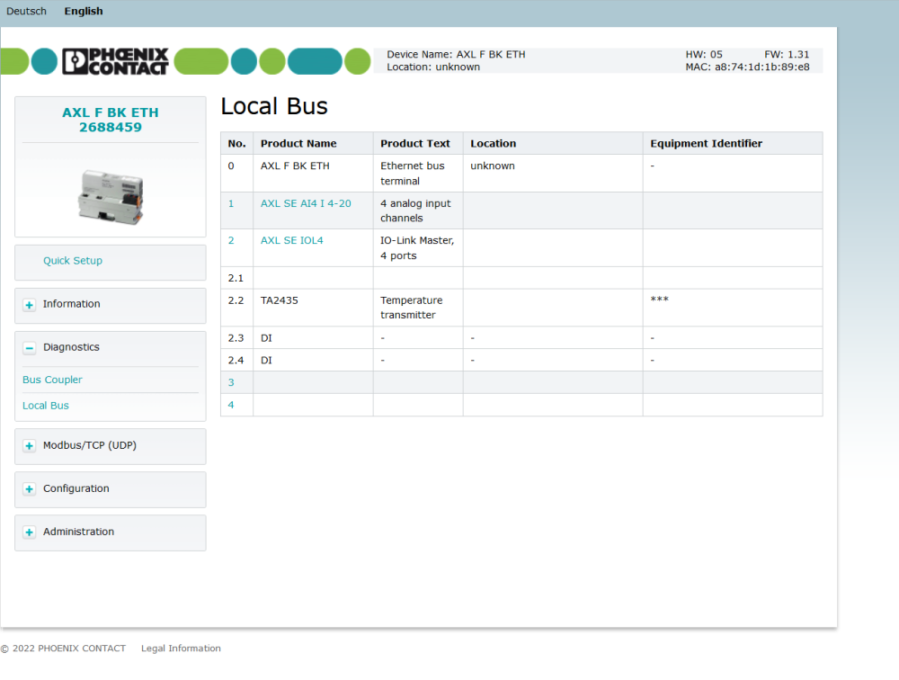

We have connected the valve to the first port, all setup operations are done (data size is set and etc.) - there are no errors, but we get zero process data (4 bytes with zeros). Corresponding screenshot from the browser:
