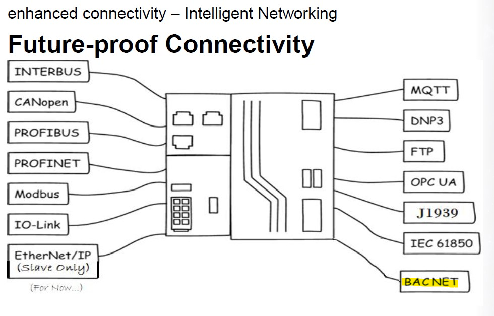

It is interesting that this slide was used in PLCnext marketing (but I do not remember where I pulled this from); maybe marketing needs to have a meeting with engineering. :slight_smile:
