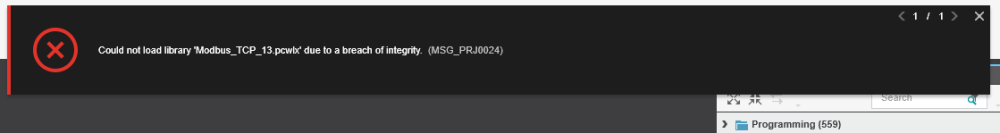

I recently tried to install the Modbus_TCP v13 and I am getting an unable to install due to a breach in integrity message. Does anyone know what this is?

Error occurs when add or replace library in the previously developed project (ide prior to 2023.6). And looks like pop-up info window in the top right corner of the screen.
For Ide 2023.0.4 LST
And warning dialog window for ide 2023.3
But it could be possible to deal with this lib if use it in PLCNext Engineer 2023.6
Please kindly read the change notes of the library.
It seems that it has adaptation to the PLCNext Engineer 2023.6 changes, so it cause problems for previous ide releases.
