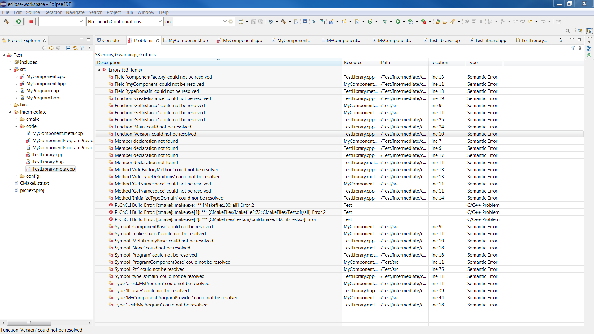

Hello, So I’m attempting to setup an Eclipse C++ program and I have followed the installation guide from: and the programming guide from: . My AXC F 2152 firmware is updated to 2020.3 and I’ve installed the PLCnext Technology C++ tool chain for Windows including Compiler, Eclipse Add-in, Microsoft Visual Studio Extension, and LibraryBuilder.
PLCnCLI_SDK_2020.3.1_Windows_AXC_F_2152.zip. At the last step of the Eclipse section, i’ve tried to build the program but I’m recieving errors from the intermediate folder. Any idea what it might be?

I think the curcial parts of the error message are ommitted in the screenshot.
Also what gets highlighted in the Library and meta.cpp file?

Please just copy the text of the error message there are information missing in your screenshot.

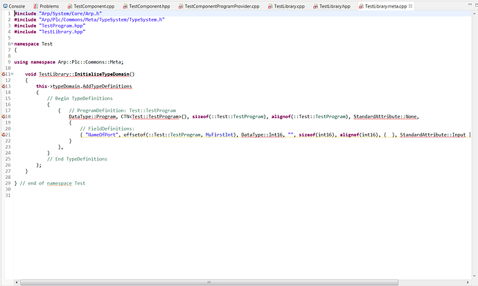

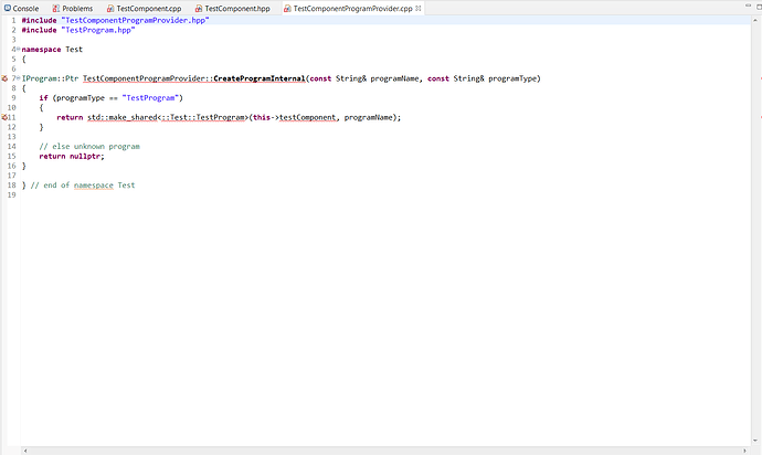

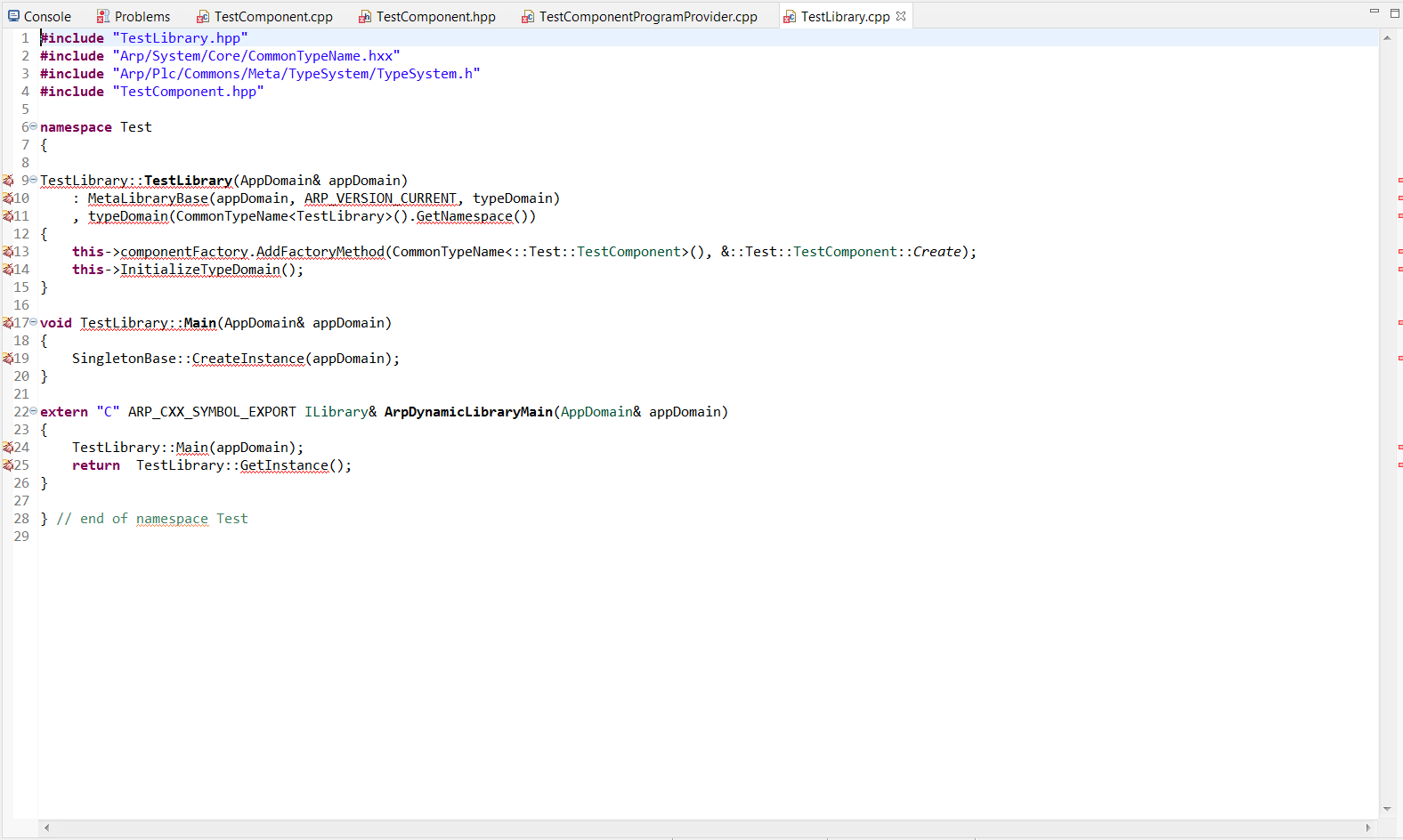

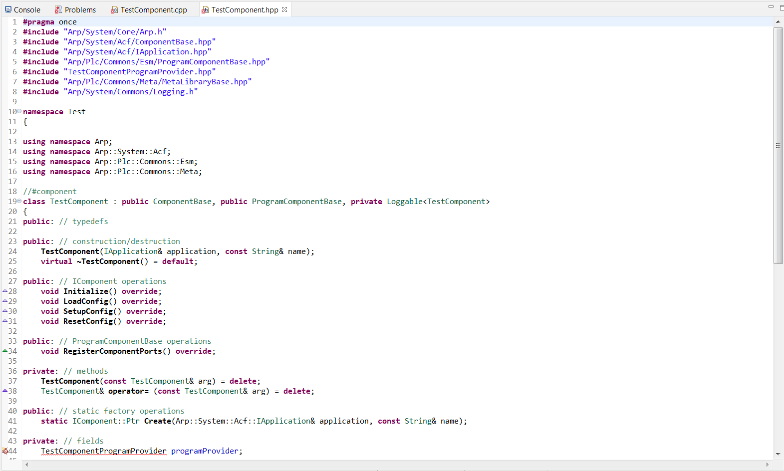

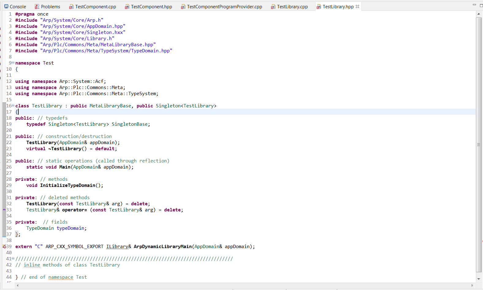

Hello Oliver, Sorry for the delayed response. When you say error messages I’m assuming the messages in the Problems window. Description Resource Path Location Type

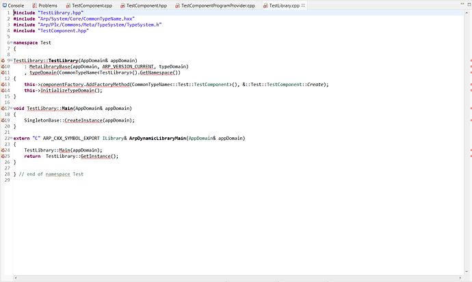

Field ‘componentFactory’ could not be resolved TestLibrary.cpp /Test/intermediate/code line 13 Semantic Error

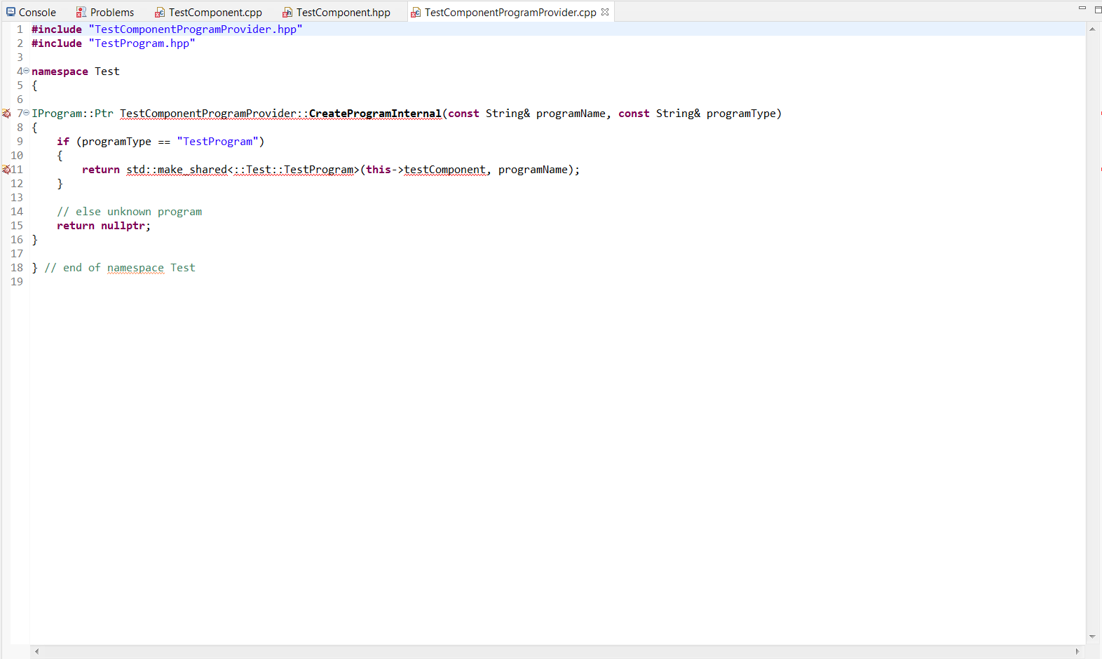

Field ‘myComponent’ could not be resolved MyComponentProgramProvider.cpp /Test/intermediate/code line 11 Semantic Error

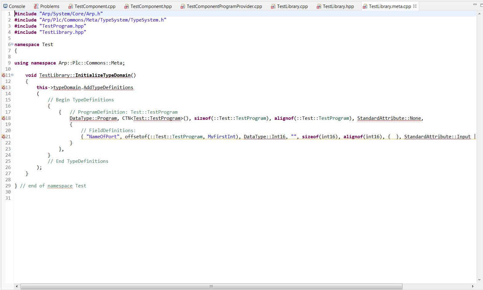

Field ‘typeDomain’ could not be resolved TestLibrary.meta.cpp /Test/intermediate/code line 13 Semantic Error
Function ‘CreateInstance’ could not be resolved TestLibrary.cpp /Test/intermediate/code line 19 Semantic Error

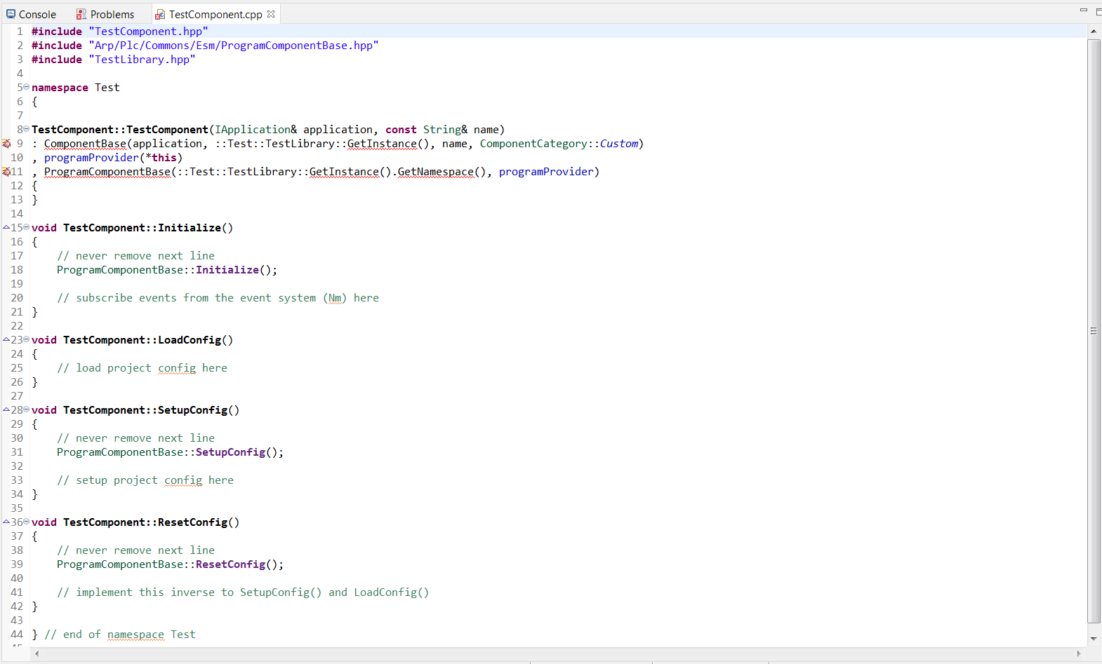

Function ‘GetInstance’ could not be resolved MyComponent.cpp /Test/src line 9 Semantic Error
Function ‘GetInstance’ could not be resolved MyComponent.cpp /Test/src line 11 Semantic Error
Function ‘GetInstance’ could not be resolved TestLibrary.cpp /Test/intermediate/code line 25 Semantic Error
Function ‘Main’ could not be resolved TestLibrary.cpp /Test/intermediate/code line 24 Semantic Error
Function ‘Version’ could not be resolved TestLibrary.cpp /Test/intermediate/code line 10 Semantic Error
Member declaration not found MyComponentProgramProvider.cpp /Test/intermediate/code line 7 Semantic Error
Member declaration not found TestLibrary.cpp /Test/intermediate/code line 9 Semantic Error
Member declaration not found TestLibrary.cpp /Test/intermediate/code line 17 Semantic Error
Member declaration not found TestLibrary.meta.cpp /Test/intermediate/code line 11 Semantic Error
Method ‘AddFactoryMethod’ could not be resolved TestLibrary.cpp /Test/intermediate/code line 13 Semantic Error
Method ‘AddTypeDefinitions’ could not be resolved TestLibrary.meta.cpp /Test/intermediate/code line 13 Semantic Error
Method ‘GetNamespace’ could not be resolved MyComponent.cpp /Test/src line 11 Semantic Error
Method ‘GetNamespace’ could not be resolved TestLibrary.cpp /Test/intermediate/code line 11 Semantic Error
Method ‘InitializeTypeDomain’ could not be resolved TestLibrary.cpp /Test/intermediate/code line 14 Semantic Error
PLCnCLI Build Error: [cmake]: make.exe: *** [Makefile:130: all] Error 2 Test C/C++ Problem
PLCnCLI Build Error: [cmake]: make.exe[1]: *** [CMakeFiles/Makefile2:73: CMakeFiles/Test.dir/all] Error 2 Test C/C++ Problem
PLCnCLI Build Error: [cmake]: make.exe[2]: *** [CMakeFiles/Test.dir/build.make:182: libTest.so] Error 1 Test C/C++ Problem
Symbol ‘ComponentBase’ could not be resolved MyComponent.cpp /Test/src line 9 Semantic Error
Symbol ‘make_shared’ could not be resolved MyComponentProgramProvider.cpp /Test/intermediate/code line 11 Semantic Error
Symbol ‘MetaLibraryBase’ could not be resolved TestLibrary.cpp /Test/intermediate/code line 10 Semantic Error
Symbol ‘None’ could not be resolved TestLibrary.meta.cpp /Test/intermediate/code line 18 Semantic Error
Symbol ‘Program’ could not be resolved TestLibrary.meta.cpp /Test/intermediate/code line 18 Semantic Error
Symbol ‘ProgramComponentBase’ could not be resolved MyComponent.cpp /Test/src line 11 Semantic Error
Symbol ‘Ptr’ could not be resolved MyComponent.hpp /Test/src line 75 Semantic Error
Symbol ‘typeDomain’ could not be resolved TestLibrary.cpp /Test/intermediate/code line 11 Semantic Error
Type ‘::Test::MyProgram’ could not be resolved MyComponentProgramProvider.cpp /Test/intermediate/code line 11 Semantic Error
Type ‘ILibrary’ could not be resolved TestLibrary.hpp /Test/intermediate/code line 39 Semantic Error
Type ‘MyComponentProgramProvider’ could not be resolved MyComponent.hpp /Test/src line 44 Semantic Error
Type ‘Test::MyProgram’ could not be resolved TestLibrary.meta.cpp /Test/intermediate/code line 18 Semantic Error Thank you for your help, Sean

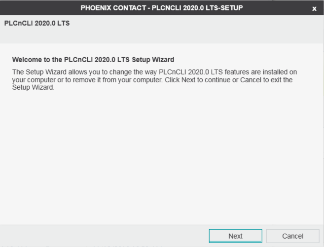

I’m not sure if this is a problem or not, but in the zip folder I downloaded off the Phoenix Contact in the AXC F 2152 software section the PLCnCLI_setup runs a 2020/0 LTS setup.

sorry i meant the compiler error message that appears in the “Console”.

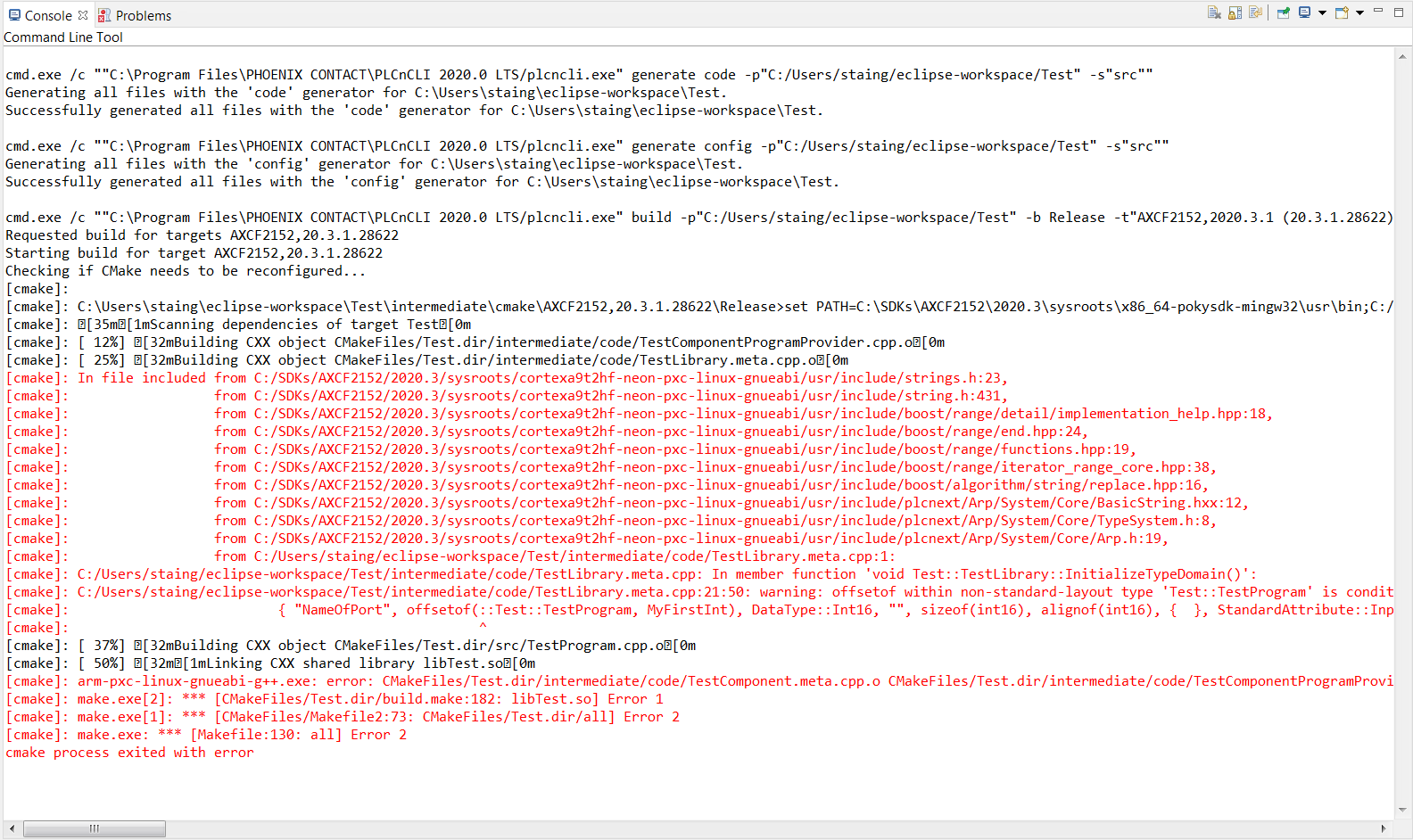

Hello Oliver, Sorry for the wrong information. This is the output from the console, whilst trying to build the project. Just extra knowledge I decided to revert to 2020.0 LTS to see if it was perhaps because I was using an archived software. Set everything up as per the “How to install Eclipse IDE tools on Windows 10 | C++ with PLCnext Technology” video, reinstalled everything according to 2020.0 LTS and managed to repeat the same result. cmd.exe /c ““C:\\Program Files\\PHOENIX CONTACT\\PLCnCLI 2020.0 LTS/plcncli.exe” generate code -p"C:/Users/staing/eclipse-workspace/Test” -s"src""
Generating all files with the ‘code’ generator for C:\\Users\\staing\\eclipse-workspace\\Test.
Successfully generated all files with the ‘code’ generator for C:\\Users\\staing\\eclipse-workspace\\Test. cmd.exe /c ““C:\\Program Files\\PHOENIX CONTACT\\PLCnCLI 2020.0 LTS/plcncli.exe” generate config -p"C:/Users/staing/eclipse-workspace/Test” -s"src""
Generating all files with the ‘config’ generator for C:\\Users\\staing\\eclipse-workspace\\Test.
Successfully generated all files with the ‘config’ generator for C:\\Users\\staing\\eclipse-workspace\\Test. cmd.exe /c ““C:\\Program Files\\PHOENIX CONTACT\\PLCnCLI 2020.0 LTS/plcncli.exe” build -p"C:/Users/staing/eclipse-workspace/Test” -b Release"
Requested build for targets AXCF2152,20.0.0.24752
Starting build for target AXCF2152,20.0.0.24752
Checking if CMake needs to be reconfigured…
[cmake]:
[cmake]: C:\\Users\\staing\\eclipse-workspace\\Test\\intermediate\\cmake\\AXCF2152,20.0.0.24752\\Release>set PATH=C:\\Users\\staing\\Downloads\\PLCnCLI_SDK_2020.0_Windows_AXC_F_2152\\sysroots\\x86_64-pokysdk-mingw32\\usr\\bin;C:/Users/staing/.p2/pool/plugins/org.eclipse.justj.openjdk.hotspot.jre.full.win32.x86_64_14.0.2.v20200815-0932/jre/bin/server;C:/Users/staing/.p2/pool/plugins/org.eclipse.justj.openjdk.hotspot.jre.full.win32.x86_64_14.0.2.v20200815-0932/jre/bin;C:\\Program Files (x86)\\Common Files\\Oracle\\Java\\javapath;C:\\Windows\\System32\\Wbem;c:\\windows\\system32;C:\\ProgramData\\Oracle\\Java\\javapath;C:\\windows\\yagarto\\bin;C:\\Program Files (x86)\\Windows Live\\Shared;C:\\Program Files\\Calibre2\;C:\\Program Files (x86)\\Skype\\Phone\;C:\\Program Files\\Common Files\\Autodesk Shared\;C:\\Program Files (x86)\\Autodesk\\Backburner\;C:\\Program Files (x86)\\HI-TECH Software\\PICC-Lite\\9.50\\bin;C:\\Program Files (x86)\\Skype\\Phone\;C:\\Program Files\\Common Files\\Autodesk Shared\;C:\\Program Files (x86)\\Autodesk\\Backburner\;C:\\Program Files (x86)\\HI-TECH Software\\PICC\\9.83\\bin;c:\\Program Files (x86)\\Microsoft SQL Server\\100\\Tools\\Binn\;c:\\Program Files (x86)\\Microsoft SQL Server\\100\\DTS\\Binn\;C:\\Program Files (x86)\\IVI Foundation\\VISA\\WinNT\\Bin\;C:\\Program Files\\IVI Foundation\\VISA\\Win64\\Bin\;C:\\Program Files (x86)\\IVI Foundation\\VISA\\WinNT\\Bin;C:\\Program Files (x86)\\Phoenix Contact\\Visu+2.42\;C:\\Program Files (x86)\\Phoenix Contact\\Visu+2.42\\AlarmDispatcher;C:\\Program Files (x86)\\Phoenix Contact\\Visu+ Express 2.42 Build 1154.8\;C:\\Program Files (x86)\\Phoenix Contact\\Visu+ Express 2.42 Build 1154.8\\AlarmDispatcher;C:\\HT-PIC\\BIN;C:\\Users\\staing\\eclipse\\cpp-2020-092\\eclipse;
[cmake]: e[35me[1mScanning dependencies of target Teste[0m
[cmake]: [ 12%] e[32mBuilding CXX object CMakeFiles/Test.dir/intermediate/code/TestComponent.meta.cpp.oe[0m
[cmake]: [ 25%] e[32mBuilding CXX object CMakeFiles/Test.dir/intermediate/code/TestComponentProgramProvider.cpp.oe[0m
[cmake]: [ 37%] e[32mBuilding CXX object CMakeFiles/Test.dir/intermediate/code/TestLibrary.cpp.oe[0m
[cmake]: [ 50%] e[32mBuilding CXX object CMakeFiles/Test.dir/intermediate/code/TestLibrary.meta.cpp.oe[0m
[cmake]: [ 62%] e[32mBuilding CXX object CMakeFiles/Test.dir/src/TestComponent.cpp.oe[0m
[cmake]: [ 75%] e[32mBuilding CXX object CMakeFiles/Test.dir/src/TestProgram.cpp.oe[0m
[cmake]: [ 87%] e[32me[1mLinking CXX shared library libTest.soe[0m
[cmake]: arm-pxc-linux-gnueabi-g++.exe: error: CMakeFiles/Test.dir/intermediate/code/TestComponent.meta.cpp.o CMakeFiles/Test.dir/intermediate/code/TestComponentProgramProvider.cpp.o CMakeFiles/Test.dir/intermediate/code/TestLibrary.cpp.o CMakeFiles/Test.dir/intermediate/code/TestLibrary.meta.cpp.o CMakeFiles/Test.dir/src/TestComponent.cpp.o CMakeFiles/Test.dir/src/TestProgram.cpp.o : No such file or directory
[cmake]: make.exe[2]: *** [CMakeFiles/Test.dir/build.make:185: libTest.so] Error 1
cmake process exited with error In regards, to the other solutions. I have double checked to ensure that the SDK is installed correctly. Prior it was not installed in the Downloads folder, but in the C drive like the vid recommended. So i moved the SDK to the Downloads folder and the program still fails. I have also checked that the SDK folders have the same permissions as in your photo. SDKPath.PNG SKDs.PNG Downloads.PNG For making a project on the Desktop. Im assuming you mean changing the Eclipse workspace to the desktop. I did it, the project was created fine but the result was still the same. For using the CMD terminal i followed the steps but when try to use “plcncli.exe set target --add -n axcf2152 -v 2020.3”. CMD.PNG Thank you, Sean
error:
No such file or directory So either one of these files does not exist or is not accessable.
or
the linker arm-pxc-linux-gnueabi-g++.exe is not accessable.
(check with:
/PLCnCLI_SDK_2020.6.1_Windows_AXC_F_2152/SDK/PLCnCLI_SDK_2020.6.1_Windows_AXC_F_2152/SDK
./sysroots/x86_64-pokysdk-mingw32/usr/bin/arm-pxc-linux-gnueabi/arm-pxc-linux-gnueabi-g++.exe --version
check in your explorer that the g++ can be executed.
Maybe you have some kind of firewall/antivirus that delets binaries (cpp.o files) during the build process or something?
