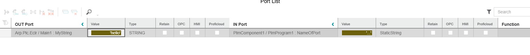

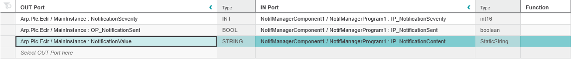

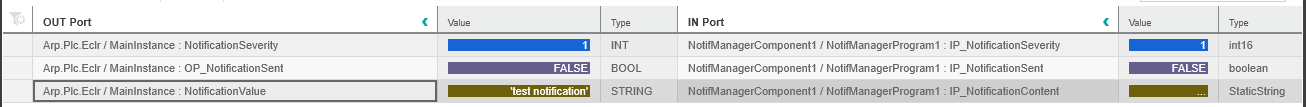

Hi again, i seem to be having trouble with sending strings, i have no idea why it isn’t working. [attachment]Screenshot_1.png[/attachment] this is what my ports look like, but the port going to c++ never has any values in it [attachment]Screenshot_2.png[/attachment] it looks like this, i have no idea why this doesn’t work. [attachment]Screenshot_3.png[/attachment] these are the ports in c++
I get the same behaviour you are seeing when I overwrite the IN port (StaticString) variable with “…” in the C++ program: [attachment]2021-05-11_10-37-23.jpg[/attachment] When I do not assign any value to the IN port variable in the C++ code, I see the expected behaviour - the value of the IN port variable in the C++ program is the same as the value of the OUT port variable in the IEC program.
I have changed this as you said and removed the overwrite from C++ but get the same as before. All i see in the C++ IN port is ‘…’ [attachment]Screenshot_4.png[/attachment] these are the C++ ports now.
Can you try this: [list] []keep the existing StaticString port, but create another StaticString Input port in the C++ program with a different name. []in the PLCnext Engineer project, link the OUT (string) port to the new IN port on the C++ program. [/list]Does this make a difference? If not, is there anything in the Output.log file that indicates an error? Also - how are you building the C++ code? Using the VS add-in? or the Eclipse add-in? or using the plcncli directly?
