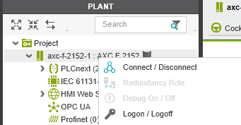

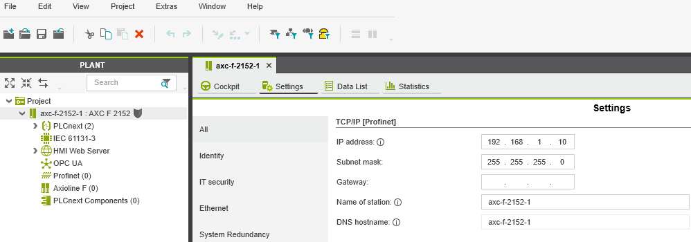

Enter the PLCs IP here:
Execute Connect
If that works you it could mean your mGuard/VPN blocks Profinet communication.
