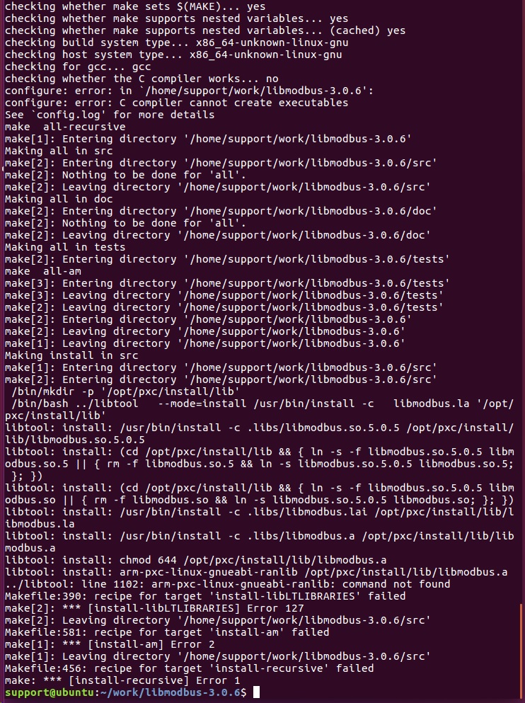

Hi When i run the sudo ./SetupConfig.sh i get following fault and then it stops the installation Makefile:390: recipe for target ‘install-libLTLIBRARIES’ failed
make[2]: *** [install-libLTLIBRARIES] Error 127
make[2]: Leaving directory ‘/home/support/work/libmodbus-3.0.6/src’
Makefile:581: recipe for target ‘install-am’ failed
make[1]: *** [install-am] Error 2
make[1]: Leaving directory ‘/home/support/work/libmodbus-3.0.6/src’
Makefile:456: recipe for target ‘install-recursive’ failed
make: *** [install-recursive] Error 1 Regards
Dan Møller PxC Denmark
Hello Dan, something is wrong with your C Compiler properbly.
Did you adapt the SetupConfig.sh for your own Operating system?
you need to adapt the path to the SDK ect… I updated my previous post with the latest version of the Modbus Example.

Hello Dan, you have to edit the *.sh file with a text editor and change the paths. where is the environment script:
"/opt/pxc/current/**environment-setup-...** "
to
"/where/ever/YouInstalledTheSDK/**environment-setup-.**.."
Where is the Sysroot:
"/opt/pxc/current/**sysroot** "
to
"/where/ever/YouInstalledTheSDK/**sysroot** "
and change the path where the compiled library is placed:
"/opt/pxc/install"
to
"/where/ever/you/want/Install"
Hi Dan, Did you manage to compile libmodbus? I just compiled the latest version this morning, was a smooth ride after configuring the right variables to point to the correct path where you have unpacked the PxC-Linux-SDK. Cheers,
