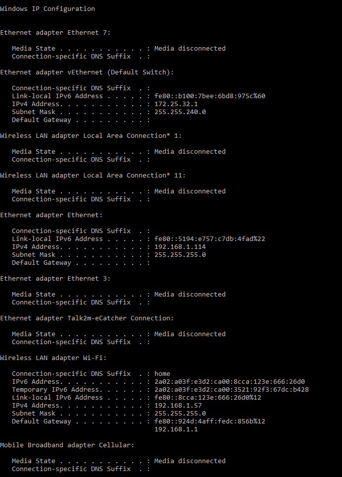

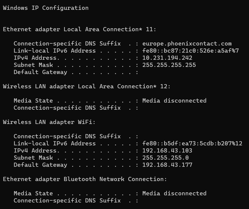

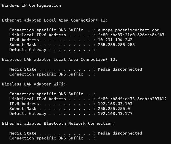

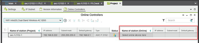

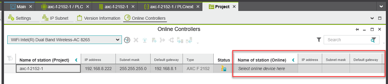

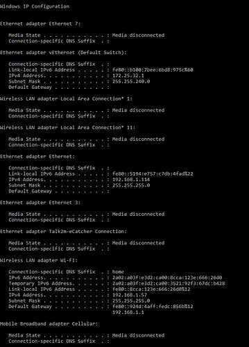

Can you please post the result of the ipconfig command in Windows, and the result of the network scan in PLCnext Engineer, showing the ip address details of the Online PLC? I have attached examples of both. I don’t have a PLC directly connected at the moment, but the area where the address details will appear is outlined in red. What LEDs are on and/or flashing on the PLC?

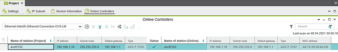

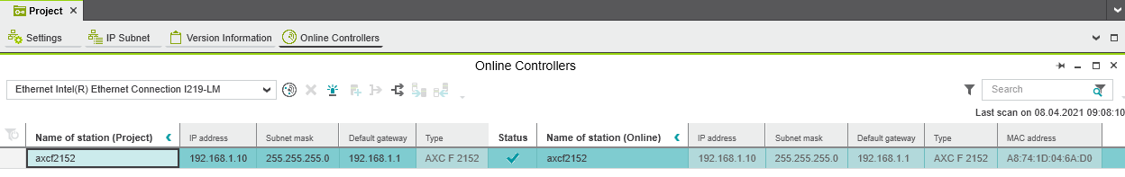

Hereby the requested printscreens and LED BF-d is flashing red and Led’s Run and D are lighting green.
There seems to be two Ethernet adapters on the same network. This might cause a problem because ip messages may be routed through the WiFi adapter instead of the Ethernet adapter. In general it is a good idea to have different Ethernet adapters on different networks or subnets. You could try changing the IP address of the Ethernet adapter and the PLC to be on a different network to the WiFi adapter. If you want the PLC to be able to access the internet, then you could try setting up routing between the two adapters on the PC, or else plug the PLC into a LAN port in the back of your WiFi adapter (if available), in which case the PLC will be accessible over WiFi. This latter arrangement works for me at home. It is possible that there is a device on the WiFi network that has already been assigned the ip address 192.168.1.10 by the WiFi router. This can be checked by removing the LAN cable from the PLC, and checking if you still get a response from the “ping” command. If so, then there is another device with that address. You should be able to check the IP addresses of all the devices on the network on the management page of the WiFi router. The router probably also allows you to set a range of IP addresses that will be automatically assigned to devices via DHCP. The static IP address that you assign to the PLC should be outside this range, otherwise the PLCs ip address may also be automatially assigned to another device. If you think this might be the problem, then please assign a new static IP address to the PLC from the Online Controllers window in PLCnext Engineer, and see if this helps.
