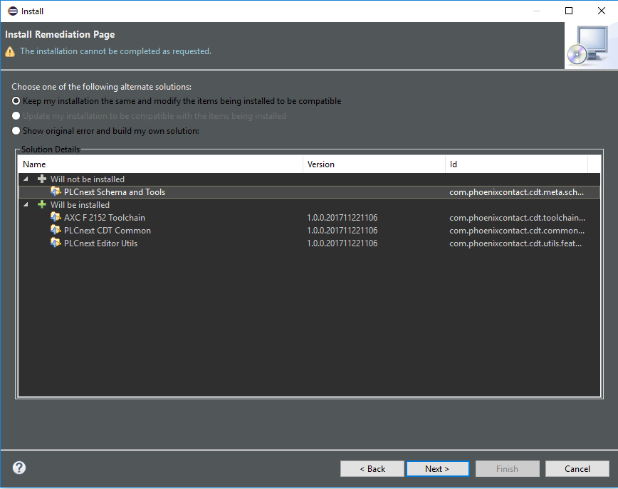

Hi Martin, Yes i am able to say that the SDK is located in C:\\Program Files\\PLCnext\\Win64 Yes i did uninstall all the files from eclipse and redownloaded the latest SDK and Plugin, upon going over the process again i found the following attached is this showing that it cannot install the program? or is it missing something? Many thanks,
Hmm, not sure what that error means but it does say that it will install the Toolchain, so … does this at least get you past the initial problem? Also, that SDK path has a space in it … between the words “Program” and “Files” … please see the notes underneath the video! - Martin.
Hi Martin, No this has not fixed the issue sadly. even after moving the “PLCnext” folder to C:\\Users\\gbbh01\\Documents\\PLCnext instead of “Program Files” which is the one shown in the video and is a windows OS folder, i have had no luck in fixing the issue. Many Thanks in advance for your Time.
