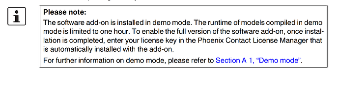

Hello, How are you?? I have an issue with a 1152 cpu. We got a model made in Simulink and we´ve been using plc next target (by using SDK) in order to put the simulink model into the plc. When we star the PLC the model is working perfect but after an hour the model task inside the plc gets stop. The PLC is still working (we have others tasks) but not the model (which was import from a file called “core.pcwlx”).
Do you know what is happening???
more data: when we Built the model from matlab we get this warning message.
warning.jpegThank you sooo much!!!
Regards.

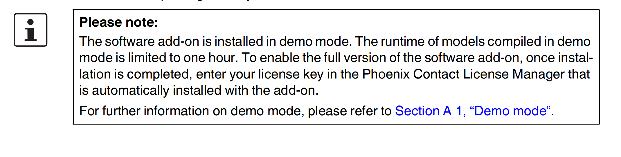

Page 14 of the User Manual includes this information:
… which seems to explain what you are seeing.
Please get in touch with your local Phoenix Contact office to either buy a license or, of you have a license already, to have them check why the license is not being recognised on your PC.
