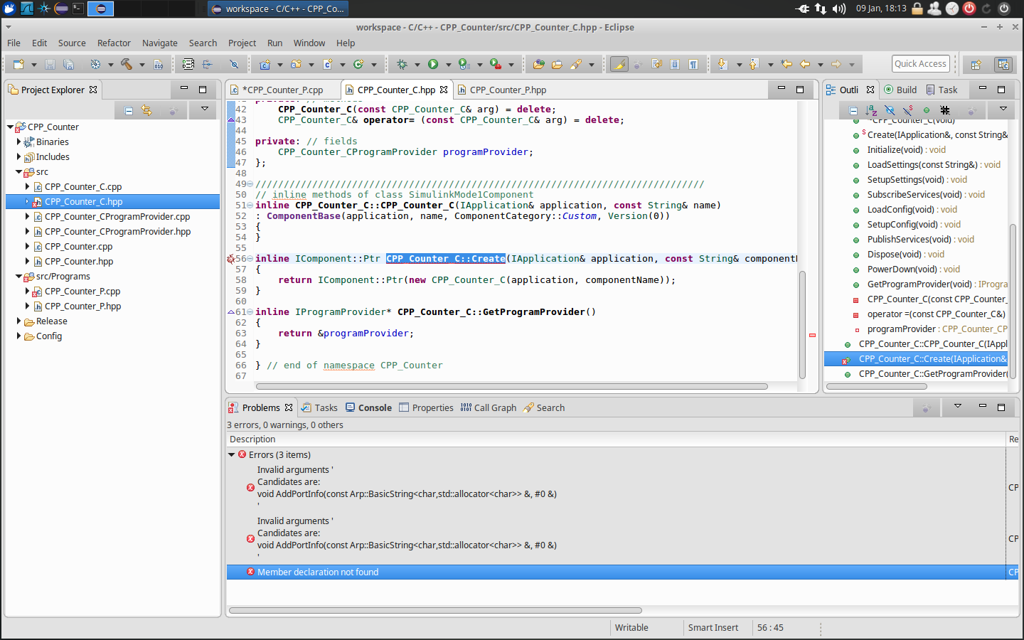

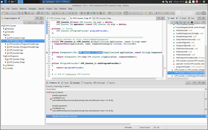

I want to create function block to PLCnext to read XML files elements. I want to read “System.Xml”. When I did add “System.Xml” I got following errors that attaches to this question. I want to know how to add System.XML to my solution. Thank you ahead for help and support. {jcomments off}{jcomments on}
Hello, system.xml is currently not supported by the real time C# runtime. Probably you can do it via C++. I do recommend not to use parsing operations in a real time program. (if files are large)
You should consider moving these operations to the non realtime part of the application.
Especially if the XML parsing is used to find starting values or something similar. - Marcel
