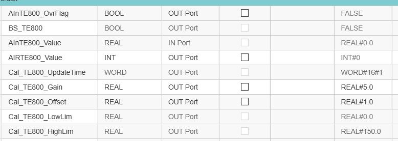

                                          1. Init value in the PLCNext does not show up in debug mode. I tried Retain option enable/disable and the default value in debug mode is always 0.

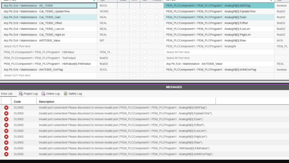

                                          2. Every time C++ library is rebuilt I have to disconnect the ports and re-assign them. This is not at all feasible as i have 2000+ variables to configure. Is there an option to avoid ports re-assignment when C++ library changes?
                                          3. Cannot upload images or copy screenshots to the post.

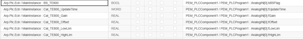

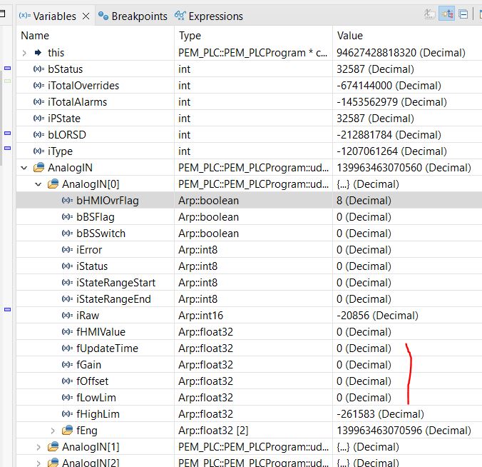

Above are the screenshots from PLCNext and C++ debug mode.

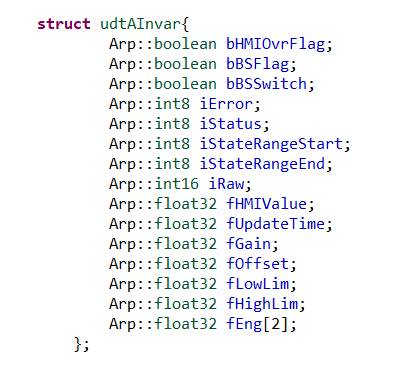

Here is the struct in C++ and does not have any initial values. I was hoping to get those from PLCNext as I have initialized PLCNext variables.
Should the initialization be done in C++? I would like it the other way around so c++ pulls values from PLCNext variables.

I just edited my C++ and rebuilt the library, and this is what I see in PLCNext app

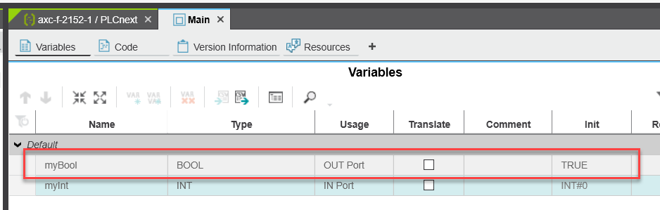

Just on the Initial value problem -

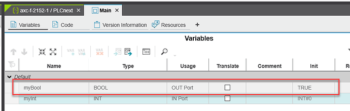

I’ve created an OUT port variable in an IEC program, with the initial value TRUE.

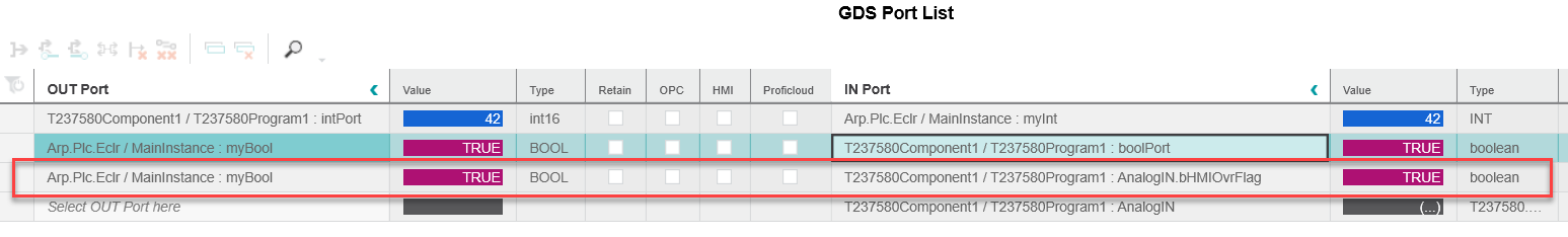

I’ve connected that OUT port variable to an IN port variable on the C++ program instance. The C++ port variable is not initialised in the C++ code.
When I go online, I can see that the IEC variable has the default value (TRUE), and that value has been transferred to the IN port variable on the C++ program:
In your PLCnext Engineer project, when you go online, what values do you see for the OUT and IN port variables?

My 2nd issue still remains. Can you please assign a struct variable to the IEC port and rebuild the library. I see the below error every time i recompile my library. No errors when the struct variables are not connected to any ports.

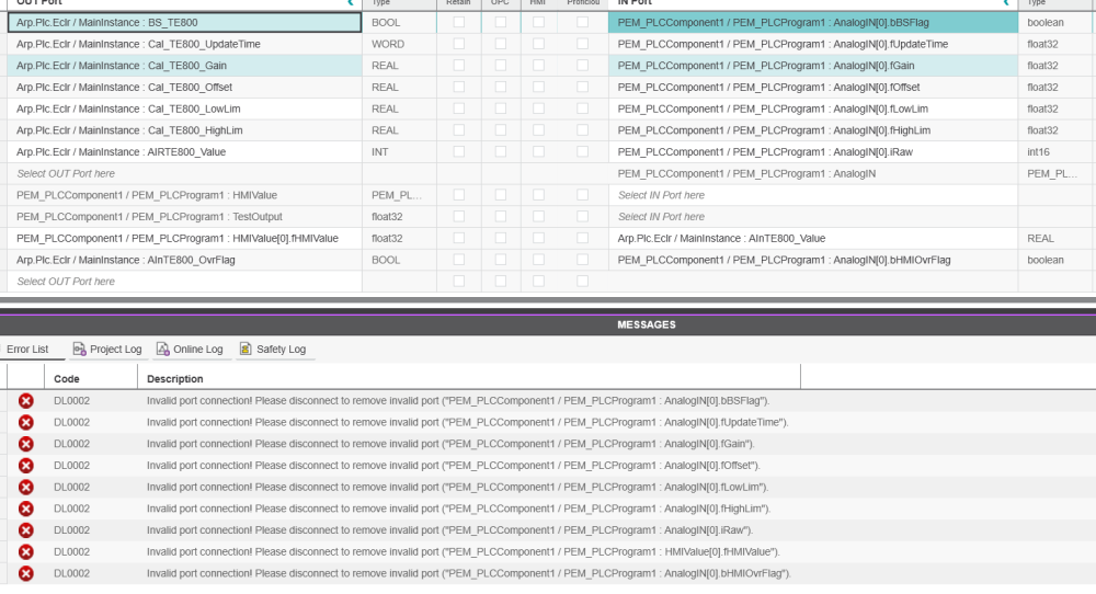

I installed 2022.6 and followed the procedure in the video, but still no luck. I see the same error. I tried assigning 1 port variable and all of them, but the result is the same.
When the library is added, I do see a message to accept the change but the option is grayed out.
This is frustrating to re-assign variables every time the library changes.
