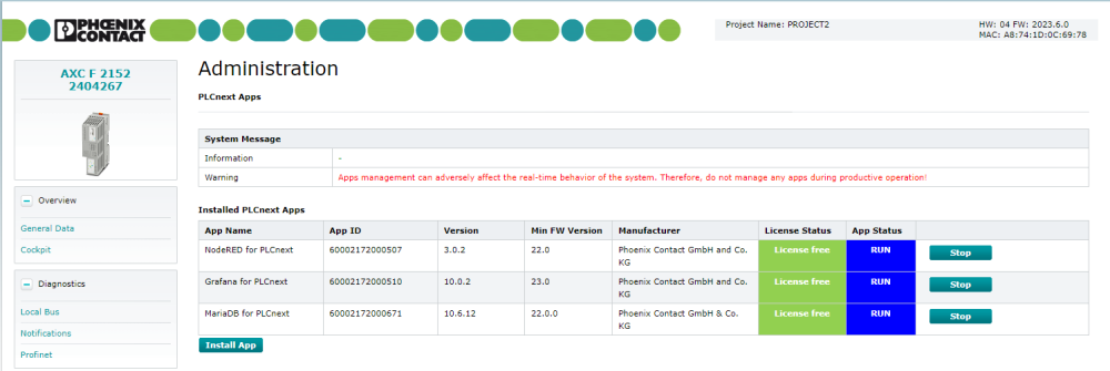

For test proposes install next apps on the plc.

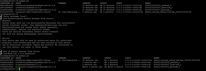

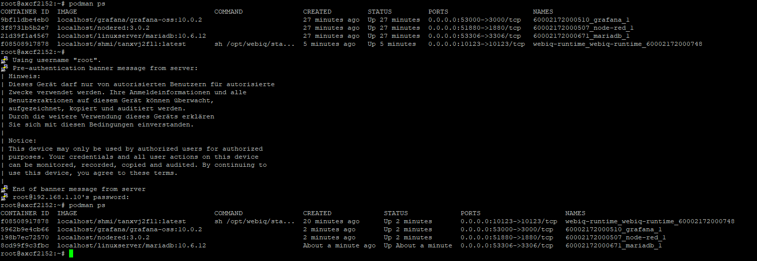

Also, via ssh check the state of podman containers.
putty1.pngAnd it work fine. But after reboot of the plc, WBM indicates that apps are ok and run, but podman ps return blank container list, and actually no response from the apps via dedicated ports…

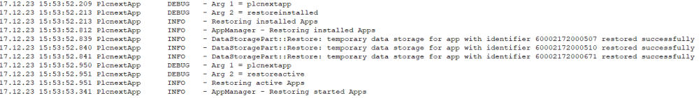

изображение.pngIf take a look at plcnextapp.log there is no errors or warnings

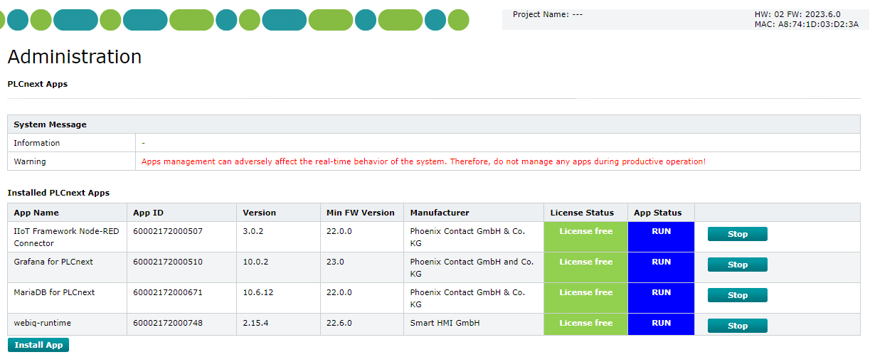

* AXC F 2152 with a factory default file system and firmware version 2023.6
* Install four container-type apps, as shown below:
* Reboot the controller.
* Open an ssh session on the controller, log in as root, and check the state of the containers:
All containers appear to have restarted successfully.
