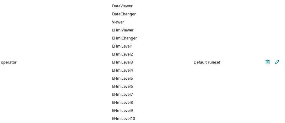

Hallo! I am trying to interface Emalytics with PLCnext via OPC UA. I have already made a connection between the Emalytics (as a OPC UA Client) andPLCnext (as a OPC UA Server) via OPC UA. As well as, I discovered and added the OPC UA Server points in the OPC UA Client point manager view (I have attached a photo). The problem is that the added point does’t begin updating with real-time values and the Ua Status Code is shown empty, as shown in below photo. Unfortunately, I couldn’t seem to find any post that would help with this so I had to write to the forum. Thank you in advance. Hiteshkumar Amipara
