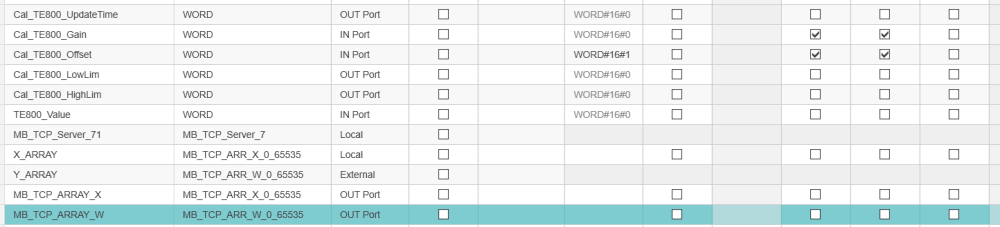

Variable definition in PLCNext:
I have played with the port types but I was able to get the writes to work. Also checked OPC/HMI options and it does nothing.

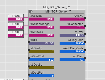

Is there any diagnostic available on the FB?
Martin,
No Error code in the function block.

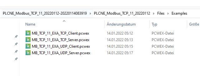

Hello Teegala3;
if you unzip the latest version of the Modbus TCP Library you will find a working example for the Modbus Server functionality.
I hope this helps.
Also as xAutoAck is always true you will mostlikely not see errors for long…
With fast cycles the debug mode will not show the error code at all probably.
To see the errors try logging the Diag registers and Error bits via the LogicAnalyser featuer.
image.pngThe connection state looks good however.

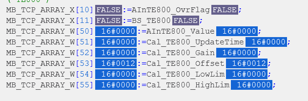

Maybe have a look at the whole register array, maybe your client adds an offset to the write Address?
Which registers are you writing to ?
Make sure not to overwrite these registers in your application.

Oliver, Thank you for pointing to the example. Example project works for modbus writes.

I have also added the Diag code to Logic analyzer but the data shows the status as 8000 and no other useful data is recorded.

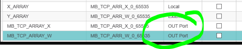

I think it’s because you are using the array as an Output Port

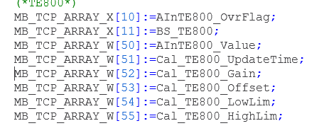

I still think the issue is that you overwrite the incoming values in your IEC Application.
Try writing to index 12 for example to see if that is possible.
e.g.
Client changes Index 10 to TRUE.
Application runs and instantly overwrites the value with the contents of AInTE800 as FALSE
