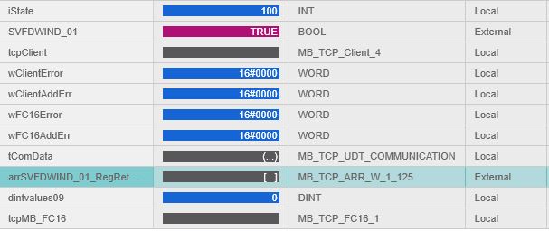

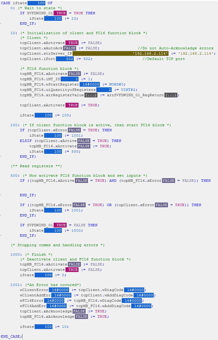

I tried the code below, stuck at state 100. Please have a look at the attached images. Controller and PLCNext Engineer have the latest updates. I just need to write to the first two registers. And if I want to read the first 120 registers at the same time, how do I do it? =========================================================================== CASE iState OF

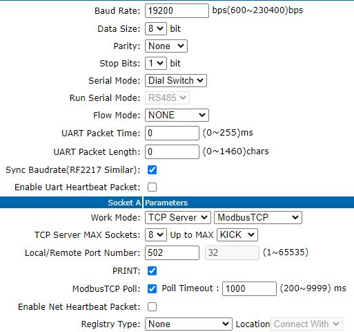

Got it now. I wasn’t calling the functions. But I am still not able to write to the registers. I initially got ClientError C410 and then C020. I am able to write to the registers using MATLAB but not through the PLC. The error codes refer to timeout errors and TCP sockets. I have attached an image of my communication settings. Could you please tell me if there is something I need to change in these settings.
Hello, If you are able to read all registers using FC3, then the communications settings are OK. The error codes you listed are from the MB_TCP_Client instance, right? I’m afraid that this doesn’t make sense to me - if you are able to read registers using FC3, then you must have established communication - without errors - using the MB_TCP_Client instance. Please make sure that you are only using one instance of MB_TCP_Client for the device, i.e. FC3 and FC16 do not need (and should not use) two different instances of MB_TCP_Client. If the communication is established successfully using MB_TCP_Client - which you have already done (?) - then the call to FC16 should work OK. ~ Martin.
Hello again, For now I am just using FC3 and I am getting a timeout error C020. I have used the same code on EMPro smart meters and they work fine without any error. I used the same code on a bitronics smart meter I get C410 clienterror but still the data is being read continuously and the diagcode stays at 8000. But, with ABB VFD I have C410 error code initially for 5 secs and I did get the right measurements, but after 5 secs I get C020 error. I was able to get continuous readings without any errors on a different software (MATLAB). I believe this is due to the difference in plc and vfd communication settings. Also where do I find the communication parameters on axcf2152? (Baud rate, parity, stop bits,…etc) I used the same communication parameters I have on EMPro smart meters but still no success.
Hi, There are no serial comms settings on the AXC F 2152, because it doesn’t have a serial port (unless you add an Axioline serial comms module). And since Modbus/TCP is not a serial comms protocol, there is no need to set serial comms parameters like baudrate etc. Perhaps I’m misunderstanding something in your setup? In any case, this seems like an application-specific problem that should be solvable with the right client and server configuration settings. If it’s ok with you, I would like to refer you to the Phoenix Contact office in your country, where an engineer will be able to help you set up the PLC for your specific application. You can find the contact details for each country on the Phoenix Contact website. When you contact them, please ask for Automation Support. If you have no luck there, please let us know and we’ll see what we can do. ~ Martin.
Thank you Martin. You are right, we are using a serial to ethernet converter as a bridge to use Modbus/TCP and it is not a phoenix contact converter. It could be the reason for our issues. I am a student at Penn State Harrisburg and the USA headquarters are only a couple miles from us. I will contact them for help. Thanks a lot for your assistance.
