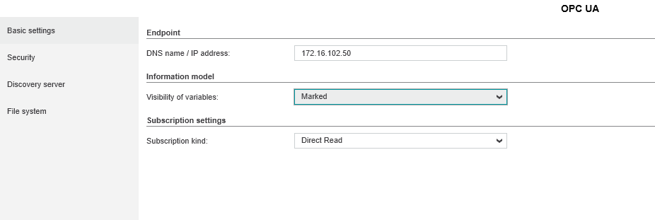

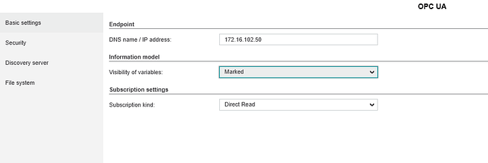

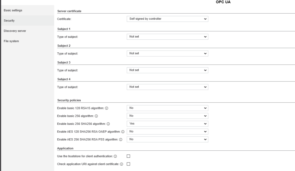

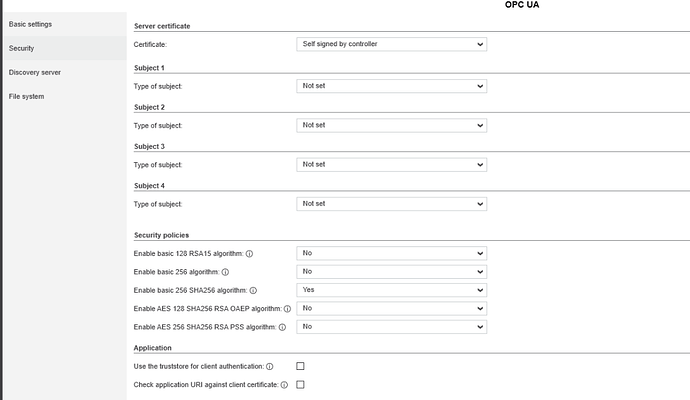

Hi Bomoirau,
May I suggest that you use the controller IP as the endpoint. The AXC-F-1152-1 doesn’t work on many UPC_UA applications.
For the use with UAExpert, have a look at my settings:
In most applications, it is not necessary to make any changes to the Discovery Server or the File system settings.
For me those settings work with UAExpert.
