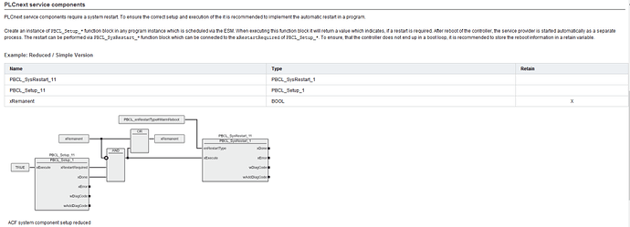

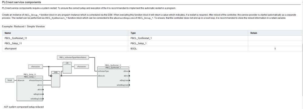

do you have the BaseService started according the manual? Parts of the library are implemented as PLCnext components which provide access from the IEC61131 application to the system and other PLCnext service components.
In ‘Usage - PLCnext Service Components’ of the manual you can find an example implementation which can be used to start up the service component.
