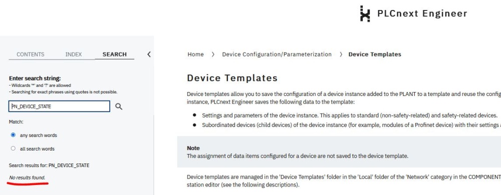

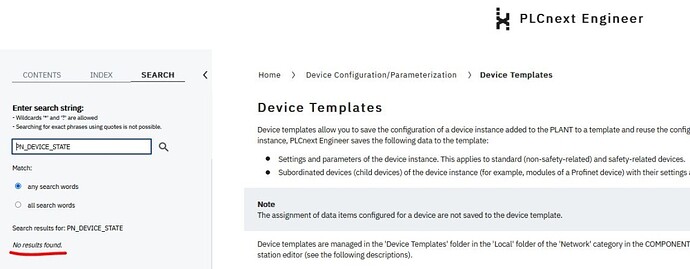

This is still not documented with 2024.0. Looking in the search section does not return anything!
