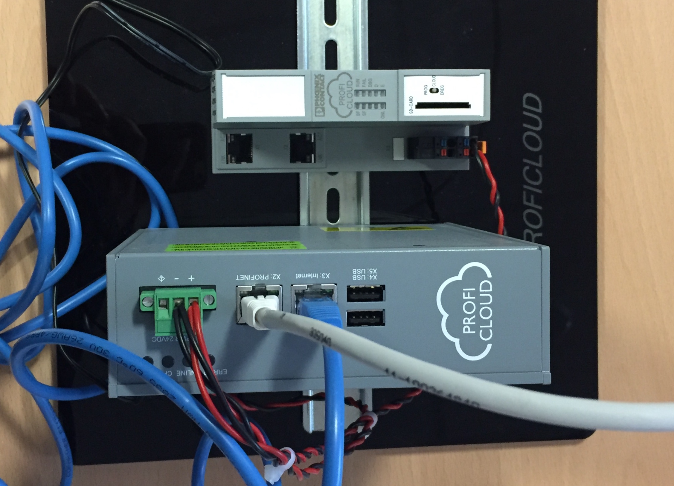

Hi, Thanks for the reply I appreciate it. As you mentioned I need a gateway for the AXC 1050, which in my case using Proficloud device and a coupler? Photo attached. What are the main purpose of these two devices. “only option is to send data from the AXC 1050 through another device that runs the cloud client software”; another device you mean the gateway attached or a PC that runs MQTT client software such as MQTT CLI…etc? So essentially I need to install MQTT client software on my PC where as mosquitto for exp. would be a broker to pub/sub to it? Hence I will be able to log data of my I/O modules to cloud for monitoring? Then proficloud.net is only for dashboards where I can subscribe to broker based on JSON strings? "Phoenix Contact representative " I am studying in uk, so should I contact info@phoenixcontact.co.uk regarding PCWORX and AXC 1050. But it is fine if I ask about proficloud here? Thanks again, Ahmed
No, I am afraid that these devices cannot act as a gateway to the Proficloud TSD service.
Those two devices are the AXC CLOUD PRO (on the top), and the the CLOUD COUPLER-PRO. They are not designed to be used with the Proficloud Times Series Data (TSD) service. Instead, these two devices work together to implement a completely different Proficloud service, in the following way: The AXC CLOUD PRO is similar (in some ways) to a standard Profinet Bus Coupler. With a standard Profinet bus coupler, you attach I/O modules to the right side of the coupler, and the Bus Coupler then provides the interface between the I/O modules, and a Profinet controller (like an AXC 1050 PLC), via a Profinet network. With the AXC CLOUD PRO, you also attach I/O modules to the right side of the “coupler”. The AXC CLOUD PRO then provides the interface between the I/O modules and a Profinet controller (like an AXC 1050 PLC), but in this case the Profinet network can be extended through the internet. So, the AXC 1050 controller and the I/O can be located on opposite sides of the world. To achieve this, the AXC CLOUD PRO must be connected to the internet through an Internet router. The Profinet Controller (AXC 1050) must also be connected to the internet, via the CLOUD COUPLER-PRO. So the network would look like: AXC 1050 — CLOUD COUPLER-PRO — (your own internet router) — [internet] — (your own internet router) — AXC CLOUD PRO with I/O modules attached. The Cloud devices must be registered in your Proficloud account to set up this network. After that, the AXC 1050 can read inputs and write outputs connected to the AXC CLOUD PRO, as if they were attached to a local Profinet Bus Coupler. This video also explains this concept: https://video.phoenixcontact.com/gwis/film/2015/15_2_071_02_Best_Practice_Proficloud_en_uk.mp4 Note that this Proficloud service is completely unrelated to the Proficloud “Time Series Data” (TSD) service. “Proficloud TSD” involves logging time-series data to a cloud database, and then visualising that data on a web-based dashboad. For that, you will need either an AXC F 2152 controller, or a Cloud IoT Gateway for your AXC 1050 controller.
