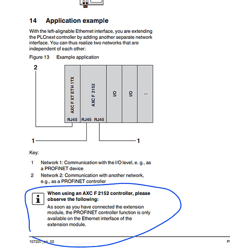

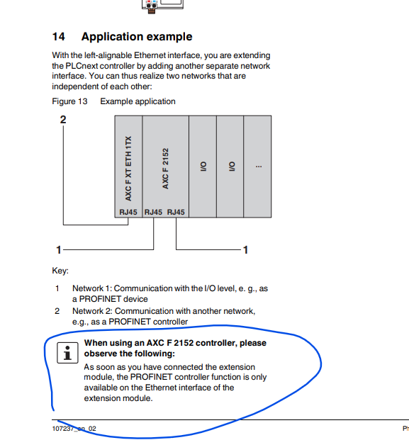

Hello, in the doc of the extention module, the following is mentioned :
Will it be changed at some point?
It limits the possible topologies and the leveraging of the original switch ports from the AXC f 2152 itself.
Thanks,
Kind regards,
Adrien
Hi, this feature has been listed as a requirement for many years, but unfortunately it’s not possible to say if or when this feature will appear. If you would like to increase the priority on this feature, please discuss this with the technical people in your local Phoenix Contact office. They can collect all the necessary information and put the request through the correct channels.
