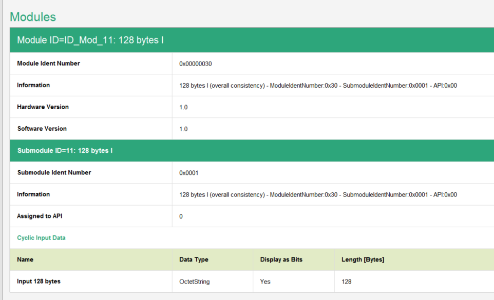

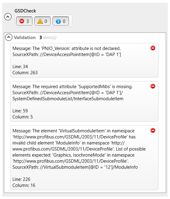

Here is the result using the GSDML file GSDML-V2.2-mdrive-SchneiderElectic-20130530.xml

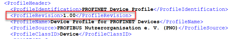

The GSDML file includes this:

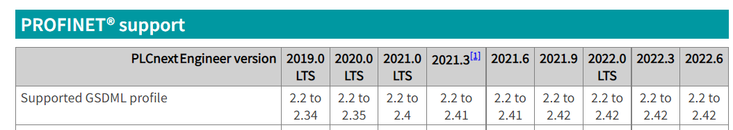

And on this page:

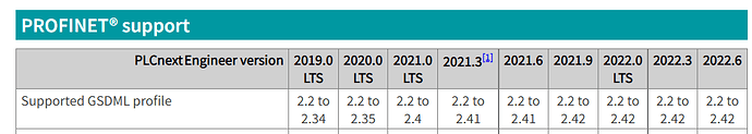

PLCnext Engineer features In this topic you see the current features and the software version with which they have been implemented. For a sneak peek into our further development and current activities on this Engineering software, please refer to the PLCnext Engineer roadmap. … it says this:
So I’m fairly sure it’s the profile version that is the problem.
Earlier versions of PLCnext Engineer gave an error message about this, so I will ask why the latest versions of PLCnext Engineer do not.
Correction:
The “ProfileRevision” in the GSDML file is not the GSDML version number - my mistake.
The GSDML file says that it complies with GSDML schema version 2.2, which is why PLCnext Engineer did not give an error message about the version number.

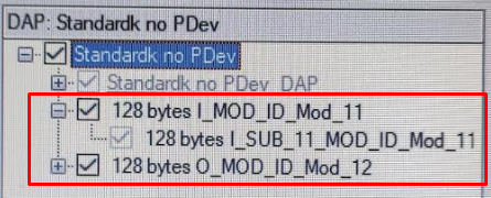

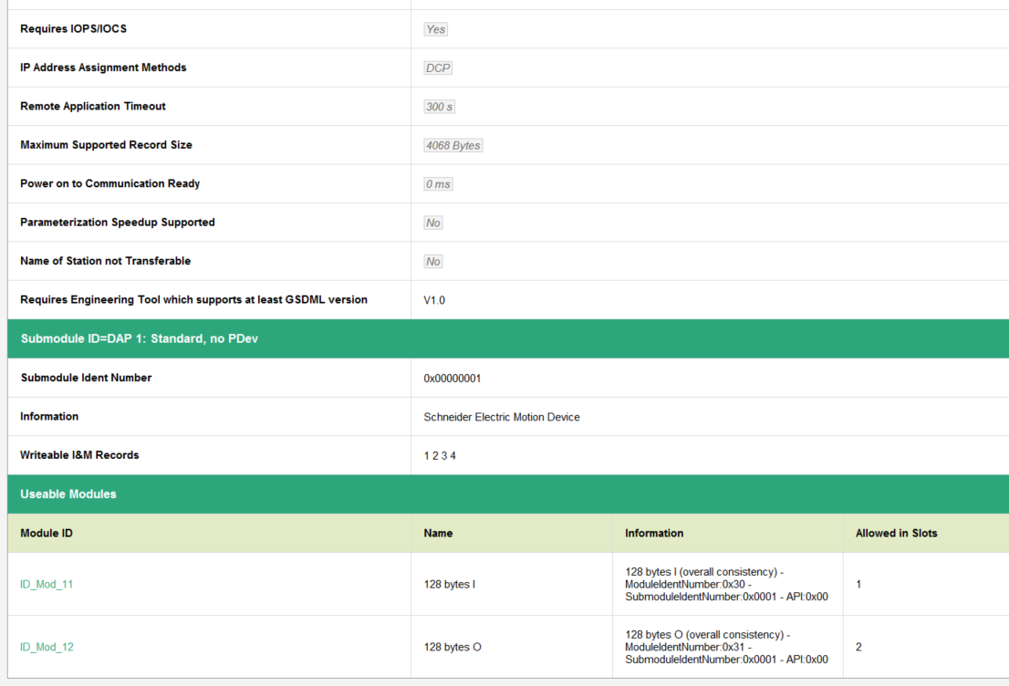

Personally, I think I have found something. As I had mentioned, I have already tried importing the GSDML file on other PLC’s. So on the software from ABB, the GSDML file does work. What I noticed was that with the ABB software, there are 2 more files displayed that are not displayed on the PLCnext.
Importing GSDML file on ABB:
Importing GSDML file on PLCNext:
So I think that the error message that PLCnext gives means that these two submodules are missing.
PLCnext error message.pngSo now I still have the question why PLCnext engineer cannot read this GSDML file properly and is missing the submodules?

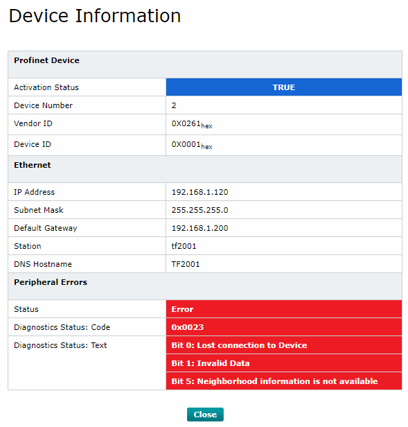

I am still getting a warning on the Online Devices tab for profinet.

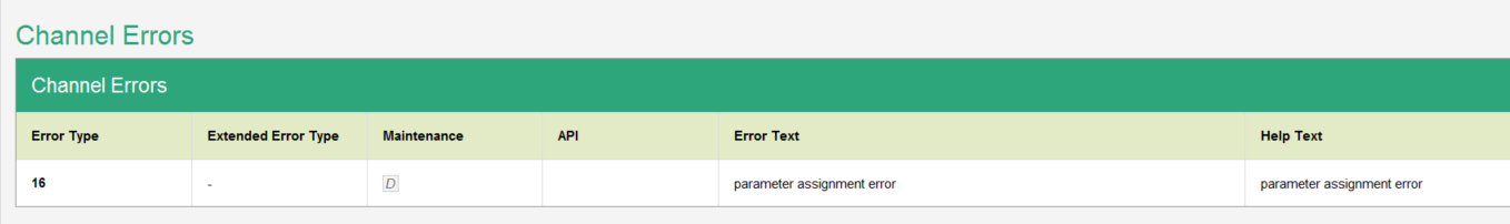

image.pngI am also getting errors that I cannot connect to the device:
I added the GSDML file over here:
GSDML-V2.2-mdrive-SchneiderElectic-20130530.zipAny idea why I am unable to connect to the motor? I am able to connect to other devices with the PLCnext.

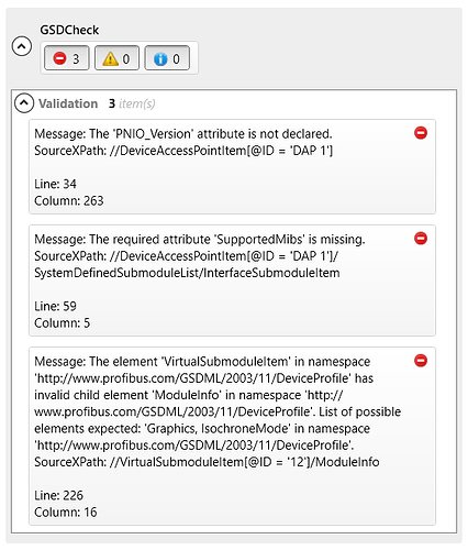

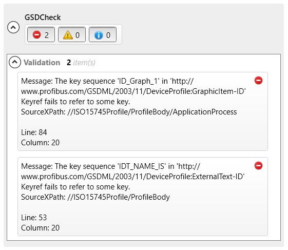

That new GSDML file fails the Profinet validation check with these errors:
You will need to check the GSDML specification to fix these errors. If there are still problems with a GSDML file that passes the check, I will ask the Engineer support team to take a look.

Hey Martin,
I rewrote the GSDML file from a template in the hope that that removes the errors. Could you do a GSDML check for this one?
GSDML-V2.4-mdrive-SchneiderElectic-20130530.zip

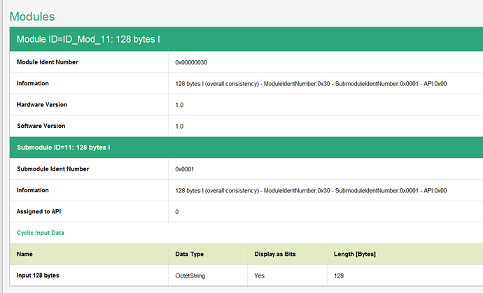

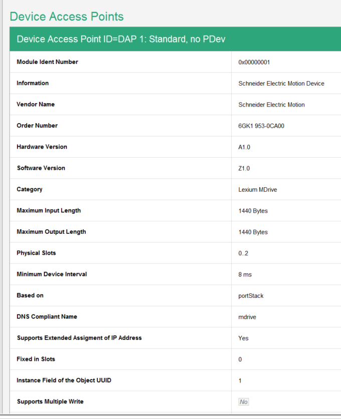

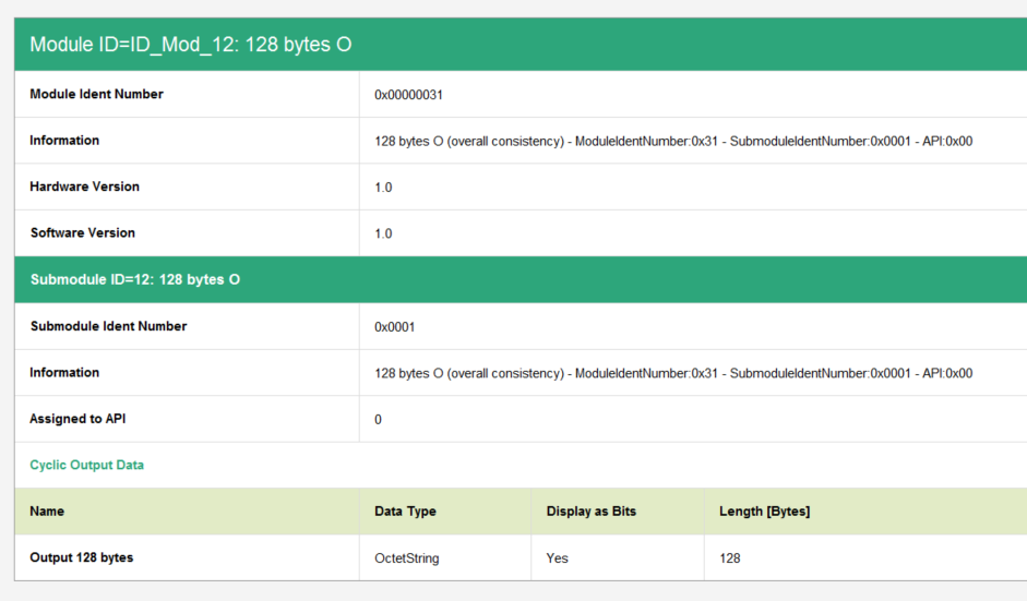

Here is the result of the GSD check:
This one should have solved these problems.
The GSD Checker does not report any errors with that file.

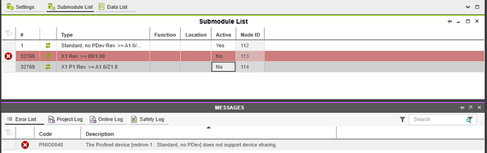

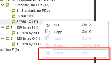

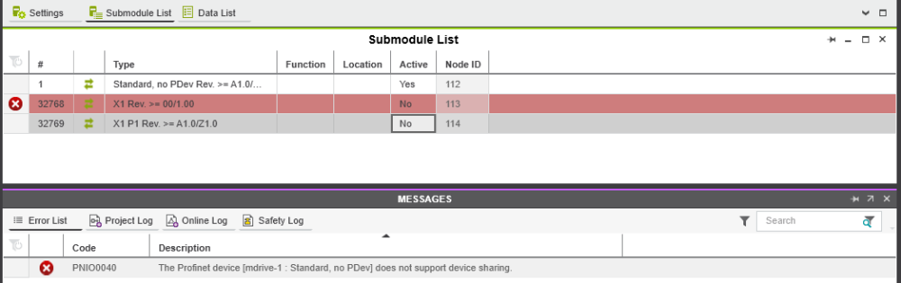

That’s good to hear, Still the GSDML file does not work on PLCnext. The GSDML file does work on ABB when the submodules that had to be added are disabled, Is there possibility to delete/disable the submodules after importing them on the PLCnext?
When I try to disable it I get this error message:
