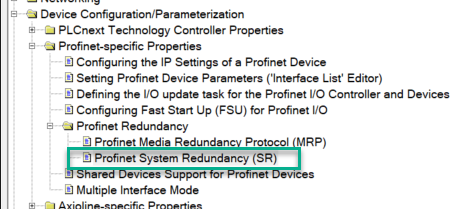

Good Morning Andreas, to your first question might the following article in our PLCnext Info Center be helpful: Configuring PN Devices You find the Infocenter in the Knowledge Base Menu with tons of other how tos and tutorial videos. Now coming to the a bit more special question of the S2 redundancy. Since PLCnext Engineer takes care of most of it, the setup is quite simple. You only have to activate the redundancy function and configure the IP of the Bakcup controller. As the application and configuration has to be the same, does PLCnext Engineer download to both PLCs. Please find more details for the configuration in the PLCnext Engineer help. To make it even more convenient, do we offer a library called “Applicative System Redundancy” which handles the whole (and sometimes) application sychnronisation and redundancy switching for you. The library is for free and released, but as a bit consulting is necessary only available via our sales representatives. If you are interested, please come back to your contact. Hope that helps, Frank
