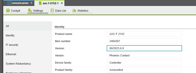

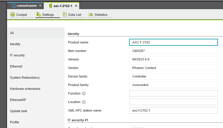

2. Please update fw of plc in theproject to 2023.6, when deal with 2023.9 PLNEngineer
This two steps allow me to deal with connection, managed by project sample you provide.

Indeed, if I leave the DEST_PORT parameter empty in the PLC or specify -p in the NC call on the client, both versions work correctly. What I don’t understand is why, using the same calls and the same code, it worked with version 2023.0 and didn’t work with 2023.9. Nevertheless, thanks for your response; it has solved my issue.
