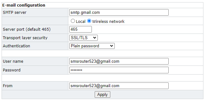

I’m planning on using the TC ROUTER 3002T-4G to sent an e-mail, but am unable to connect to it even while troubleshooting in the linux directly. When I connect using the SMS port SMS messages work, and i tried sending e-mails while connected to this SMS port, but got an error.
Screenshotd 2024-03-19 100305.pngScreenshot 2024-03-19 100835.pngScreenshot 2024-03-19 100856.png
May 31 02:23:07 msmtp: host=smtp.gmail.com tls=on auth=on user=smsrouter523@gmail.com from=smsrouter523@gmail.com recipients=does55512@gmail.com,robbe.ceulemans2003@gmail.com errormsg='cannot locate host smtp.gmail.com: Name or service not known' exit

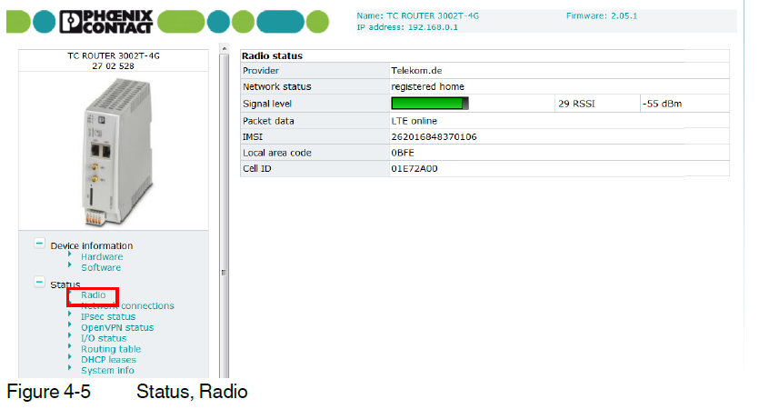

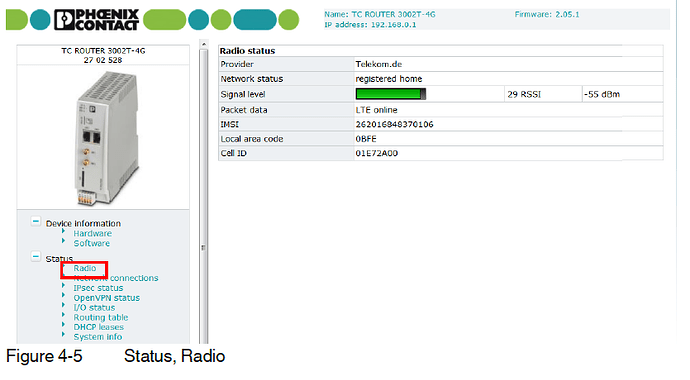

Is the TC Router showing an active connection to the wireless network?
Look at the Status → Radio page
Is the TC Router showing an active connection to the wireless network?</p>Look at the Status → Radio page</p>[https://forum.plcnext-community.net/uploads/EGER7XAKA9PB/image.png</a></p>
yes, I’m now having another problem, which gives me the following code.
Mar 19 14:30:48 msmtp: host=smtp.gmail.com tls=on auth=on user=smsrouter523@gmail.com from=smsrouter523@gmail.com recipients=does55512@gmail.com,robbe.ceulemans2003@gmail.com smtpstatus=534 smtpmsg='534-5.7.9 Application-specific password required. Fo
it cuts off there even when i download the log
