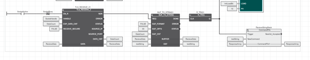

I am currently using a TCP/IP socket to communicate with a third party controller. The communication is working quite well at this point for single transmissions. The controller that I am communicating with works on a Receive Command/Respond with data type system. One command results in one response.
The problem I am having is that a few commands have a 2 message response to 1 command. So I a two packet response and the packets are really close together on the order of less than 10ms between. The TLS module is receiving both packets, I tell this by the data byte count, but it appears that the packets are being compacted together.
For instance:

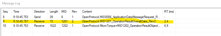

Send Message: 1 byte packet asking for measurements.
Response: Packet 1 of 73 bytes and Packet 2 of 1621 bytes is sent to the PLCNext.
The TCP Receive functions show 1694 bytes received. meaning that both packets are received.
Then this goes into a BUF_TO_STRING block to convert the BYTES to strings for parsing.
The BUF_TO_STRING is only reporting (capturing) the first 73 byte message. The rest of the message is lost.
Anyone else ever seen this or fixed this before?

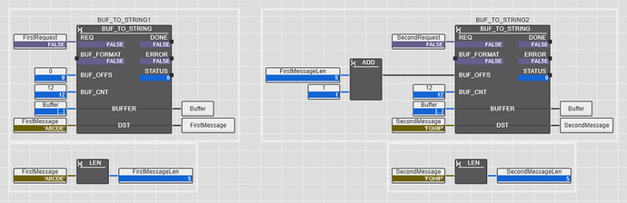

I don’t think the documentation on the BUF_TO_STRING FB is especially clear on this point, but I think the FB will stop processing the buffer when it gets to a null byte, as Oleksandr has suggested.
You can check that the second message is in the buffer by calling a second instance of the BUF_TO_STRING FB with the same buffer, but with the BUFF_OFFS input parameter set to 74. That should decode the second message.
If the null character turns out to be the problem, then you could do a check on the size of the string that is returned by the BUF_TO_STRING FB, and if it’s shorter than you’re expecting you could call a second instance of the FB, using the BUFF_OFFS parameter to decode the next message in the buffer.

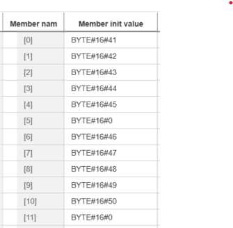

I’ve confirmed that it’s the null character that’s the problem in this case.
In this example, I’m converting the following buffer to a STRING:
The first BUF_TO_STRING instance doesn’t convert the whole buffer; it stops when it sees the first null character.
The second BUF_TO_STRING instance starts where the first instance stopped, and converts the remainder of the message to a STRING.
If there are even more messages in the buffer, this process could be repeated until all the messages have been extracted from the buffer.

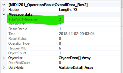

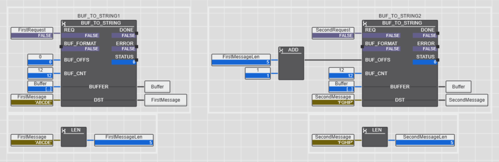

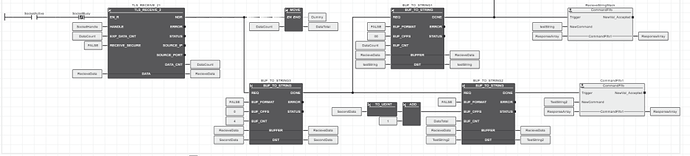

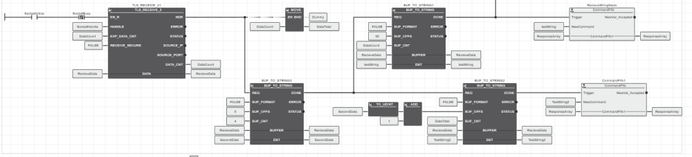

Martin - This solution is something I already developed on my own this last week. However, how would I arrange this if I didn’t know how many packets where going to show up?
In the example above and other data there is a header that shows what is coming, see attached picture, and how many messages are in the package. do you have a recommendation on how to setup this communication to be flexible with an unknown number of packets (messages).
Also I do have some packages or most of my packages that don’t have this total number of messages, but I do have a message size. My solution shown below will handle 2 message packets, however, some of my stuff will send 3 to 6 messages.
So how would I make this work with 1 or 2 BUF_TO_STRING block and feed it different parameters each time with the same buffer or is that even possible?
One way to do what you want is to use a step sequencer to “loop” through a buffer and extract multiple messages from that buffer using a single BUF_TO_STRING FB instance. Implementing a step sequencer is far easier in Structured Text than in Function Block diagram.
