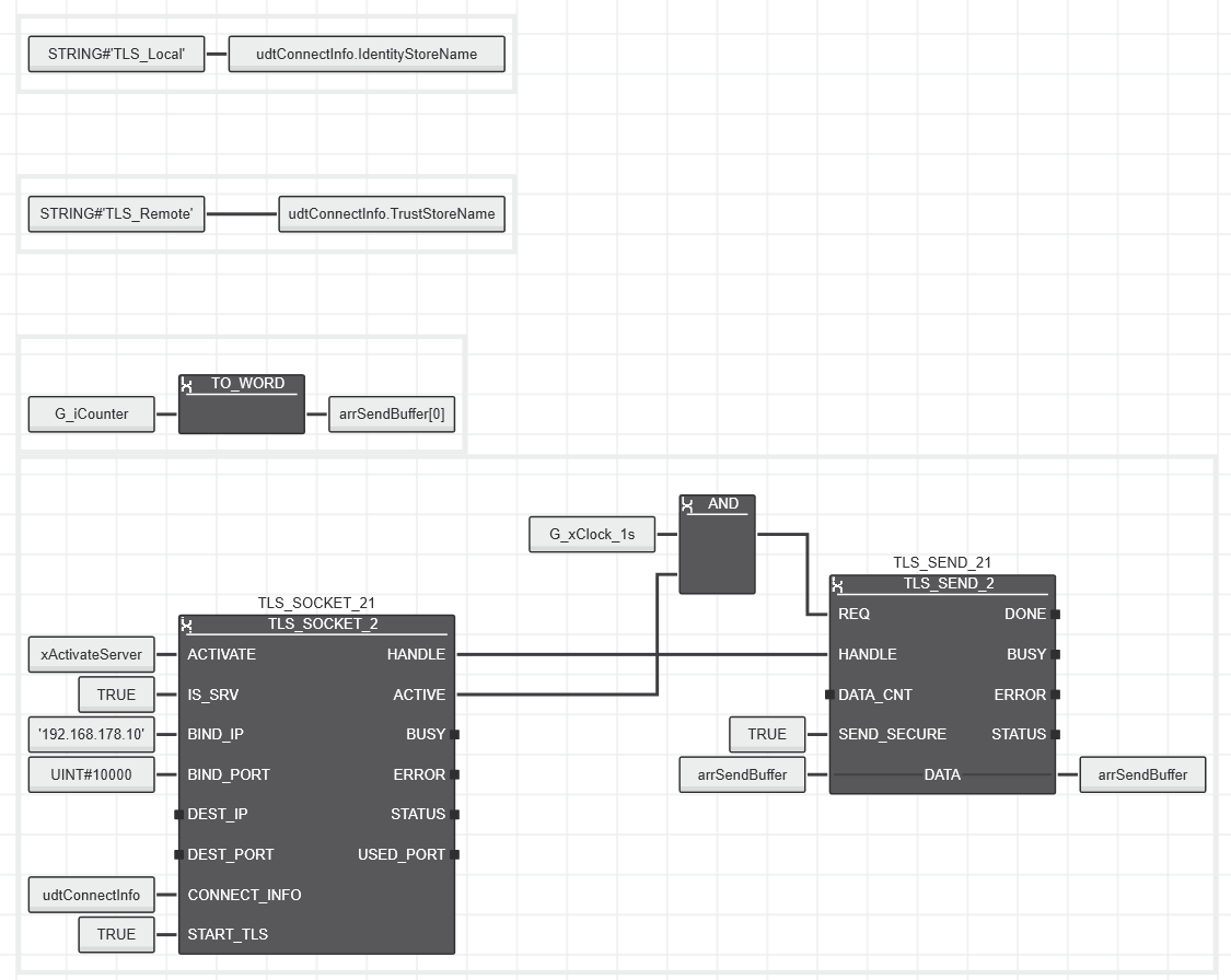

Here is a short example of a client server communication that I have written:
1. Server
It uses TLS with certificates stored on the PLC. You can turn it off by setting the SEND_SECURE input to false.

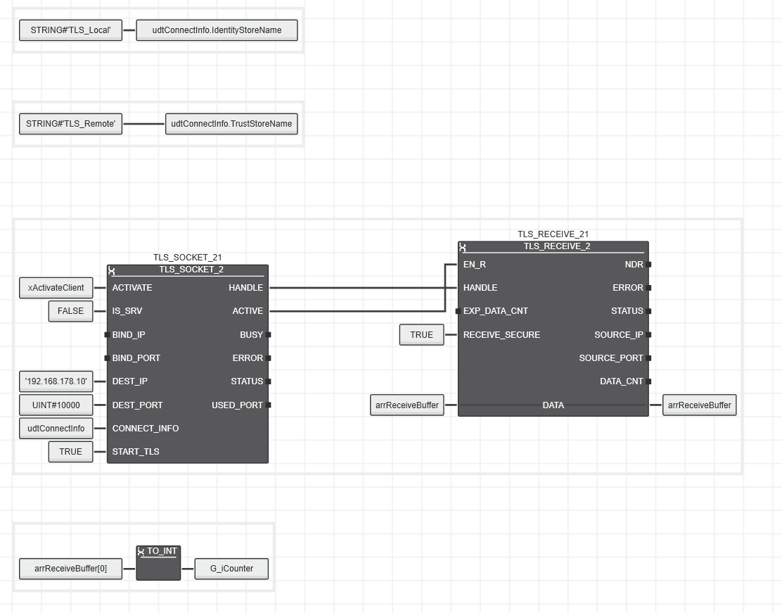

Client:
I hope this helps.
