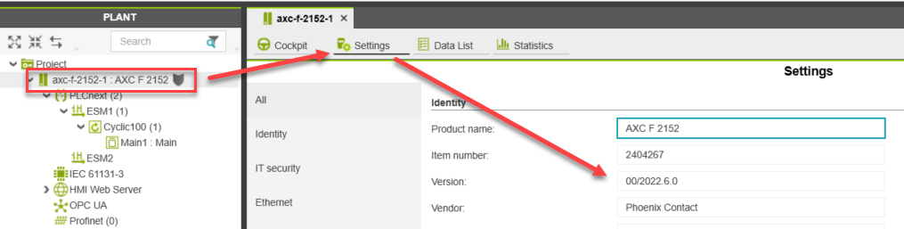

I’ve been struggling through this problem and I don’t know what to do next. When trying to detect and connect online controllers I always get under status the Yellow Triangle Warning Message that the Revisions do not match and I am unable to apply setting either to device or to project. I have uninstalled and reinstalled NPCAP, PLCnext Engineer.
I have gone as far as to try each and every 2152 Controller Rev. If I click the toggle flash on/off the plc will always flash no matter which rev I have chosen.

The firmware version on the device should be greater than or equal to the version of the device in the PLCnext Engineer project:
update. Reset and configured my ethernet IP address address again to 192.168.0.1. I was able to log into the WBM, and view the firmware version - 2021.0.3. Selected 00/2021.0.0 from the list and now I’m able to connect. I’m not sure if I did something different configuring my ethernet port this time compared to previous times but it was an ethernet port setup issue.
