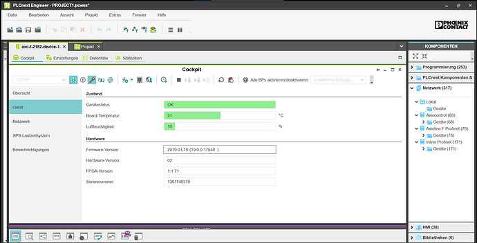

Hey plcnextstarter, I assume you are using the wbm button as shown in the following tutorial video: In that case does PLCnext Engineer use the IP configured in the project to call the browser (https://ip_in_the_project/wbm).
So, if you can connect in PLCnext Engineer with the PLC this should work.
Keep in mind, that you’ve to change likely the template of the PLC as you’ve a quite old firmware on the device. With older PLCnext Engineer version (can not really remember, but for sure already 2 yrs ago) I’ve had also with sometimes the problem that the WBM was not called correctly from the cockpit.
If you are using also an Engineer version 2019.x it makes defenetly sense to upgrade also here to a more current version. I hope that helps, otherwise please add maybe one or two screenshots were you get stuck. Take care, Frank Btw.:

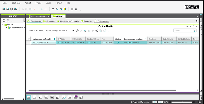

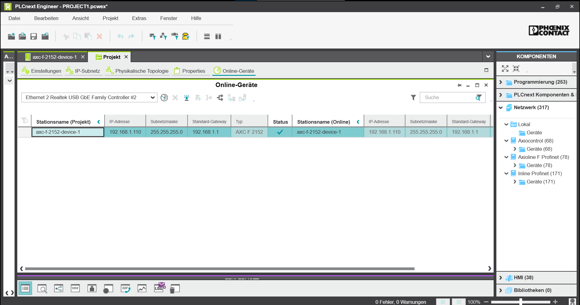

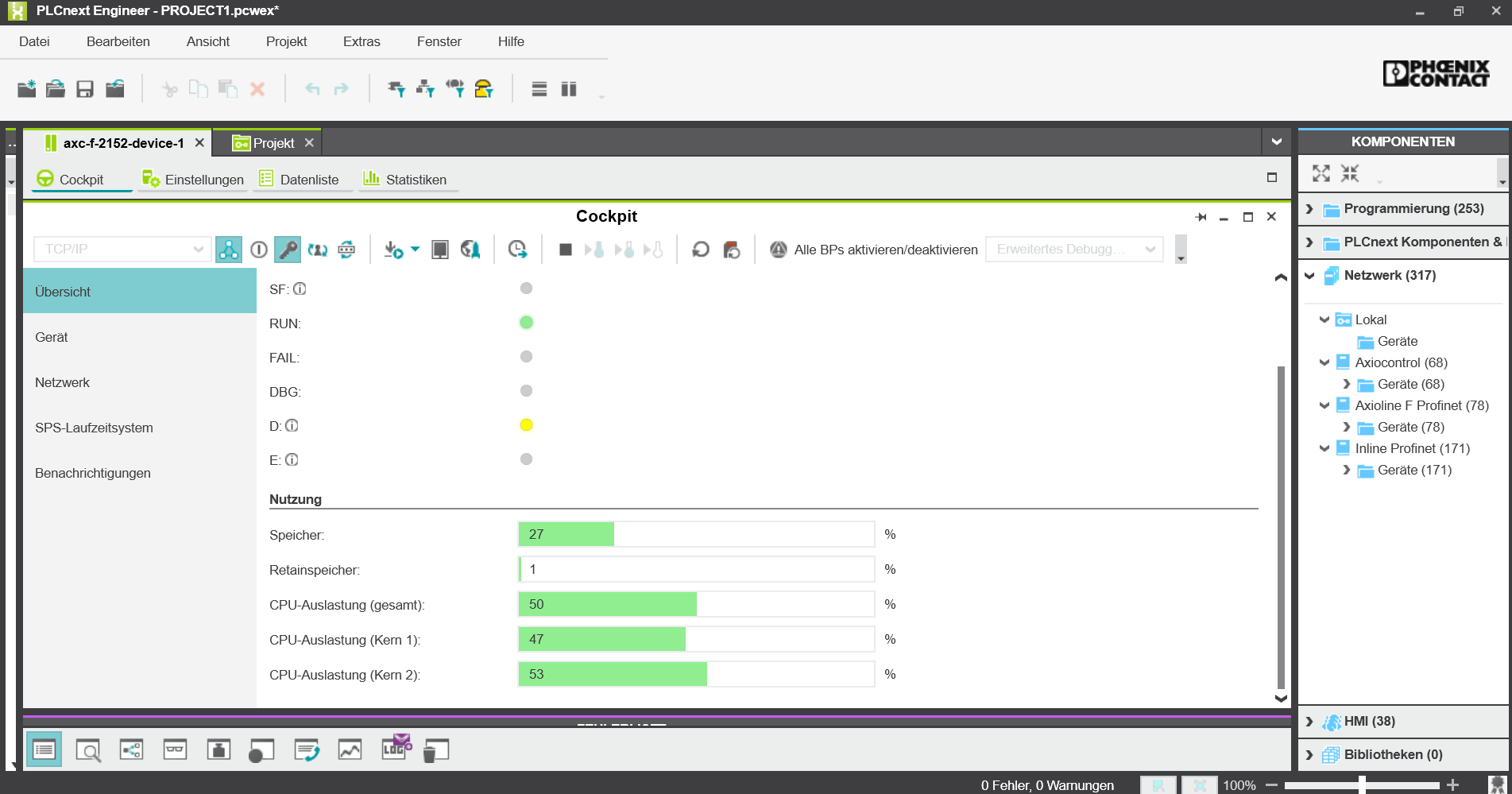

> Unfortunately I still haven't been able to establish the connection.
> I am sending you a few more screen shoots here to perhaps draw your attention to a fundamental mistake.
> Many Thanks

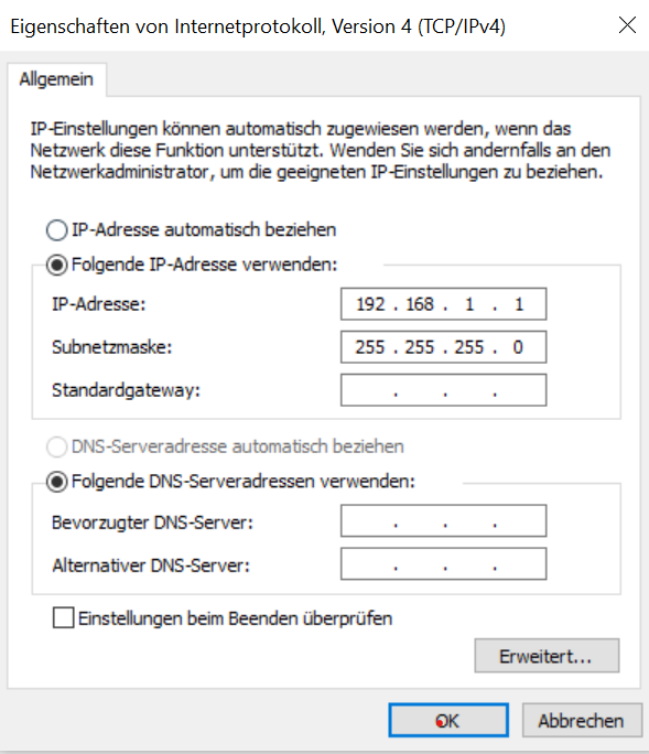

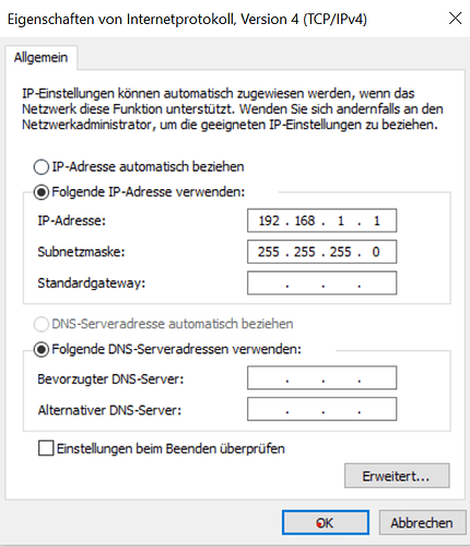

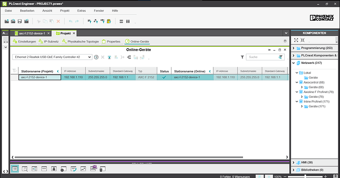

Hello, in the last screenshot it looks as if your computer has the same IP address as your default gateway (router). This is not a good idea. Try to change the IP address of your computer and see if you can access the WBM.
