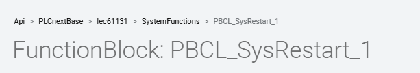

Thanks Oleksandr,
PBCL_SysRestart achieves only a PLCNext application level cold restart, which I already use scheduled daily which restores comms via RS UNI most of the time.

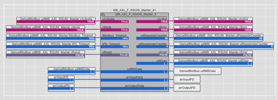

Here are some screenshots when in debug mode for a site with a locked up RS UNI (even after cold reboot):
The requests counter increases despite no responses
Eventually there is an error state, but the error code is not one that is recognised

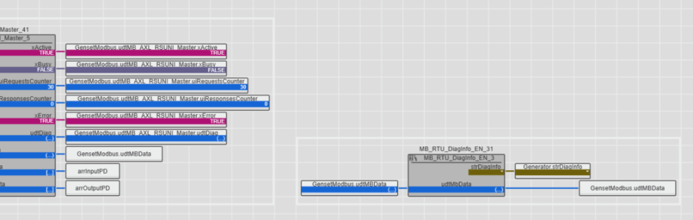

Master Diag Code is C110 and Additional Code is 0002, pulled from the MB_RTU_Diaginfo_EN_31 instance:
Which yields Configuration Function Code error, and Function Code not Valid
I also get C100 and 0004 or Modbus Error and CRC of slave response not valid

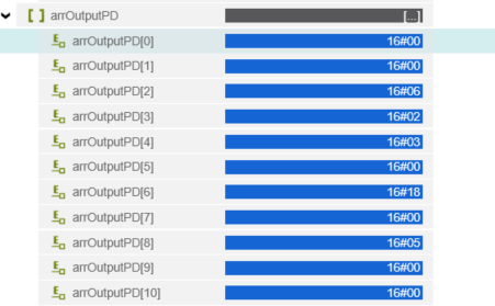

Using the watches function in PLCNext engineer I can see the data from the Master FB to the RS UNI:
00 00 06 02 03 00 18 00 05
ID 0 FC6 start add 02 end add 03 data: 00 18 CRC: 00 05 (which the CRC looks wrong)
I only have one MB_RTU_FC6 instance, which I have to modify code to be able to disable.

I’ve just noticed the 00 00 06 02 03 00 18 00 05 Byte stream doesn’t match up with the FC6 write I had programmed.
I also noticed this byte stream is in place even whilst comms are good and separately whether the FC6 FB was enabled or not, leading me to suspect this isn’t a modbus stream at all but something else.

I’m sure, that PBCL_SysRestart achieves either Warm Reboot of plc, with boot led blink, etc! Please kindly read help information about this function.
BR
Thanks, I’ll try running the RS UNI in transparent mode and see if there’s an improvement in the rate of comms loss.
The PBCL_SysRestart function only operates at the PLCNext application level, so doesn’t restart the RS UNI even under a cold restart.
