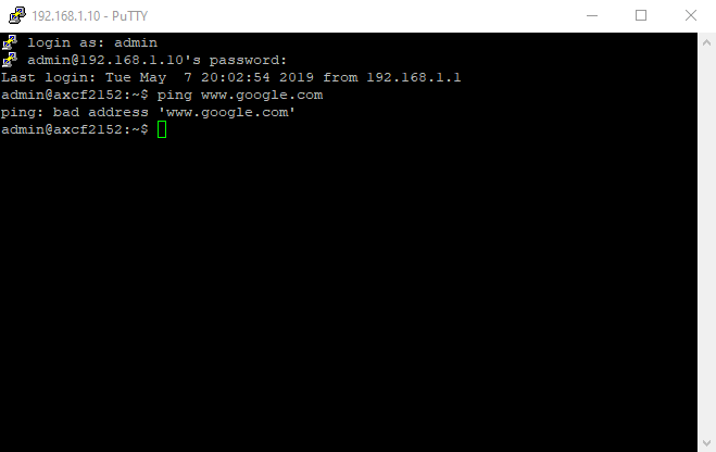

Hi, we just installed a new EPC1502. It reacts to ping requests on both ethernet port but the WBM is not served. SSH works. How do I factory reset the device via SSH?

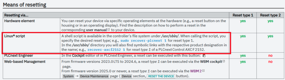

The following link provides instructions on how to reset the EPC via SSH: Overlay file system
