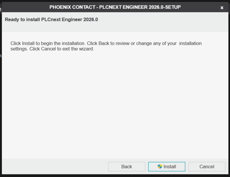

I click the Install button, but the installer just freezes and that’s it.
Expected Behavior
The IDE installs successfully on supported Windows 11 versions, including 25H2.
Actual Behavior
Installation fails on Windows 11 25H2.

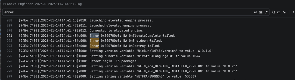

can you check if there’s a log file in C:\Users<yourWindowsUser>\AppData\Local\Temp
BR
DivisionByZero
I did encounter the same issue. It looks like the Windows UAC doesn’t appear when it should (only after I terminate the process).
When executing the setup with admin rights it gets installed.
in the logs, I see only three identical errors with the Error code 0x800700e8.

I confirm the hotfix: I ran the installer as an administrator and the IDE was installed.
if you run it without admin rights, nothing will be installed.
