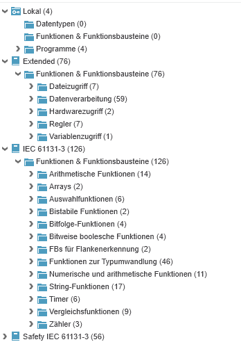

Standard Profinet library not shown
I want to use the WRREC function block to write acyclic data to a sensor,
but the Profinet functions are not shown in comonents.

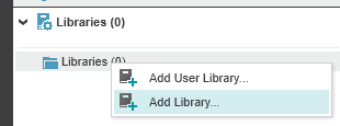

How can I add the library to the PLCnext Engineer?
Hi twagner,
Select PLCnext Controller.pcwlx
and then you’ll have the Profinet FBs
