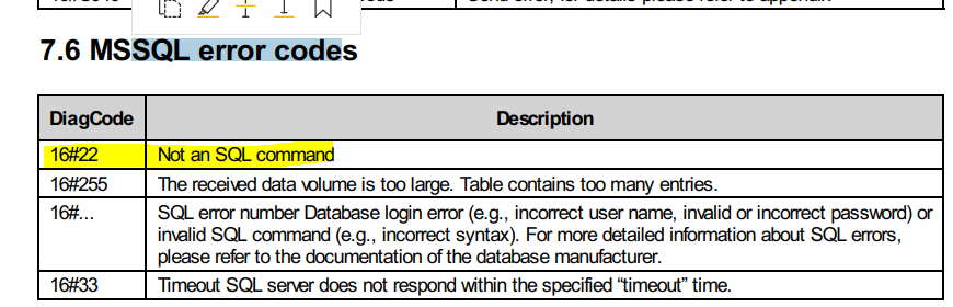

  • Dear Expert
    I'm using DBFL_SQL  Version 8.
    I can cannect to SQL, create table, but can't read table command.
    The error 16#22 happened
    How can I fix it.
    Many Thank
  • Can you please post the command you are sending to read the table?
  • Dear Sir.
    The command: "Select * from Example". This commend is execute in SQL Ok.
    Example is existed table in SQL.
