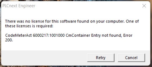

Once PLCnext Engineer is downloaded from Phoenix Contact website, and the setup wizard has been run. Software does not launch and following error is returned:
There was no license for this software found on your computer. One of these licenses is required:
CodeMeterAct 6000217:1001000 CmContainer Entry not found, Error 200.
With further investigation, I've opened the CodeMeter WebAdmin and can see the following licenses there: i) PLCnext Engineer Basic License; ii) Phoenix Contact; iii) Protection Only CmActLicense (this relates to Rockwell Automation software) that I have running on this PC.
Any ideas what may solve my problem?

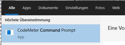

  • Please try the following steps:
     Open the Codemeter command prompt
    Use the following command to delete the registration of the codemeter service
    CodeMeter.exe /u
    Use the following command to do a new registration of the codemeter service
    CodeMeter.exe /u
    Please let us know if this fixes the problem.

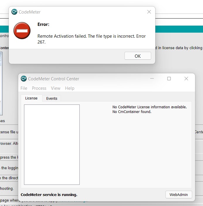

  • Hi Martin,
    I've tried Importing the licenses contained under:
    Program Files\PHOENIX CONTACT\PLCnext Engineer 2022.0\Licenses
    in the CodeMeter Control Center. However I receive the following error below:
