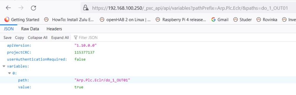

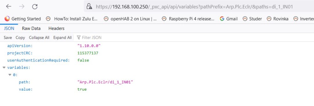

Hello Martin, Tomáš
PLC next variables are reachable via PLCnext API :0)
Answer is a parseable JSON string.
If is no HMI licence for Enable REST interface and HMI selection in data list necessary, then GET, SET statement can be used for PLC data bidirectionaly exchange.
Yes. The REST interface is unrelated to the OPC UA Client, which was the subject of the original question.
But the REST API is certainly worth considering as an alternative, so thanks for pointing this out.
