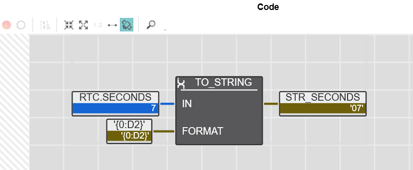

Thank you. TO_STRING helped to solve the issue:
