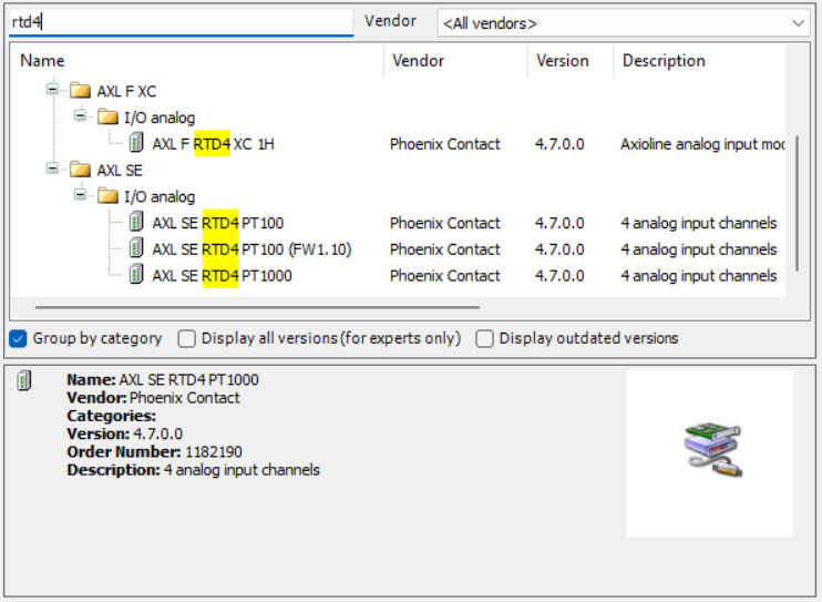

I am using CODESYS with an AXC F 2152 controller. I can read and write IO using the CODESYS runtime with most of the modules. However, when I try to use an AXL SE RTD4 PT1000 module the Axioline bus is not responding (in CODESYS the Axioline status says: not running, web based management diagnostics shows: controller is stopped, no application running, failure LED on controller lights up). After this error happens the only option I have is to reset the PLC (using sudo recover-plcnext 1), as the CODESYS runtime is stuck (even after rebooting).
I noticed that in PLCnext Engineer the RTD4 PT1000 module has firmware version 1.10. In CODESYS there is a PT100 module with FW 1.10, but no PT1000 module with FW 1.10 (see screenshot). Could the firmware version be the problem? Is there any package I could download to get access to the FW 1.10 module?
I hope anyone knows a solution to this problem. Thank you in advance!
