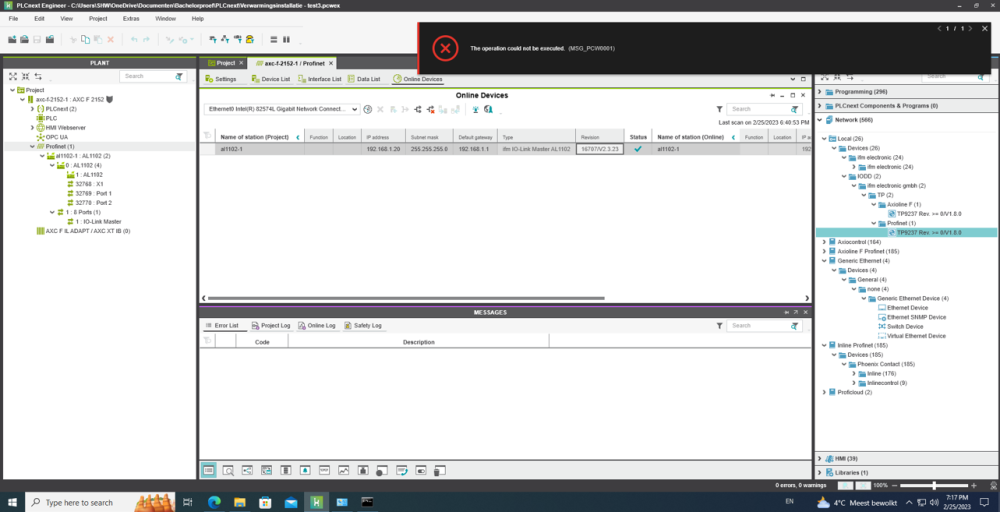

I am currently busy with my master thesis and I am using an AXC F 2152 as the controller and a IFM AL1102 master as the device. The TP9237 temperature sensor is connected to the IFM master. The master and the controller are communicating via Profinet and I just need to read out the temperature value.
I have inserted the GSDML file for the IFM master and the IODD file for the sensor. I can find/connect with the IFM module but when I drag the TP9237 IODD file to the master I get an error ("The operation could not be executed"). How can I fix this error or is there another way to read out the value of temperature sensor.
(Here is a representation of the error)

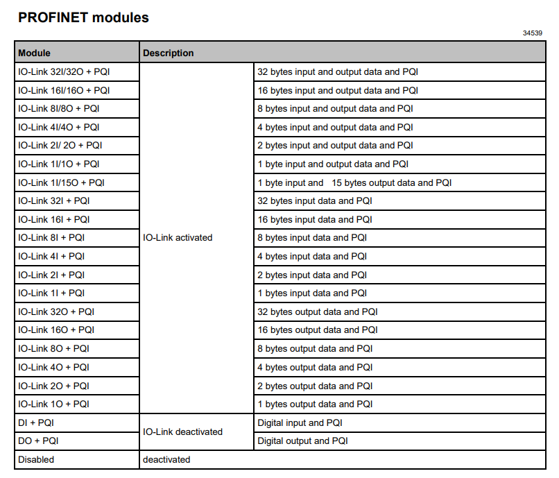

    ... and unless I'm reading it wrong (which is possible), the IODD file is not needed in PLCnext Engineer, only the GSDML file. The manual says that individual ports on the IFM device can be configured like this:
    ... where "the required Profinet module" is one of the following (depending on the type of IOL device that is connected to the port):
    These are all defined in the GSDML file for the IFM device, not in IODD files.
    Based on the IO-Link data sheet for the temperature sensor:
    ... it looks like the sensor provides two bytes of data, so I am guessing that the Profinet Module you need to use is this one:
    Unfortunately I'm not an IFM customer so I can't download their GSDML file to check this in PLCnext Engineer, but hopefully this gets you on the right path.
