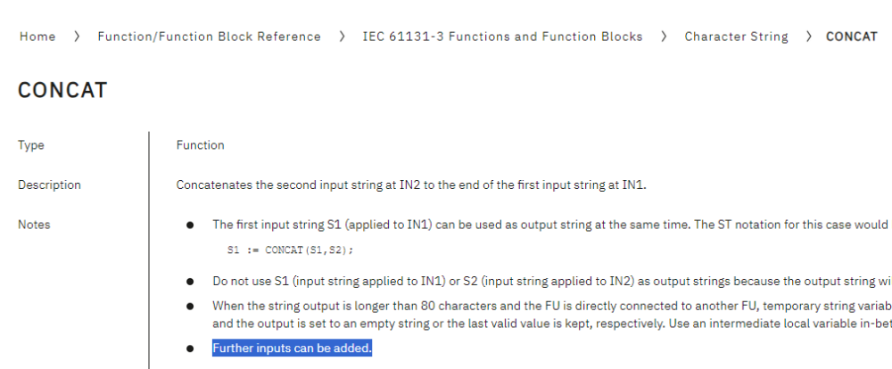

I looking through manual thousand times but never noticed this before.... It seems that this option have to be bolded and placed in the head of list)
There are a few functions that can have inputs added, e.g. the logic functions:
CONCAT is just another example of a function with this feature.
Note that it's possible to add inputs in both the ST and the FBD versions of these functions.
