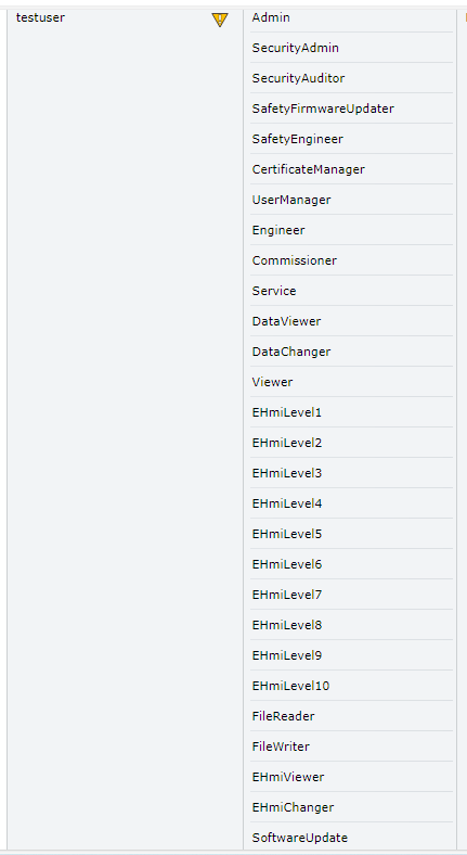

I have noticed that if you create a new user in "User Authentication" and assign some Roles. You will not be able to login with that user. Even changing a password will not work. And user will be marked with "!" in the yellow triangle saying "User default password active. But this user can't login to HMI or be used to upload a project to the PLC. Even when all roles are selected.

    • Create a new user called testuser, with the password testuser.
    • Assign the user all the roles:
