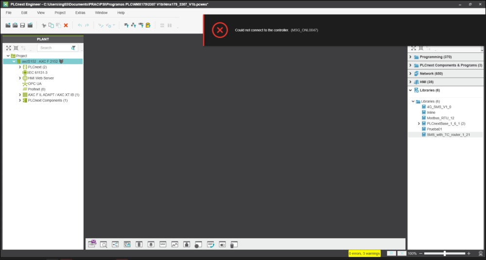

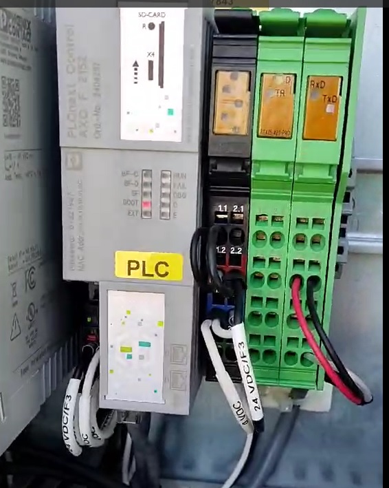

They have reported to us that at one of this measurements points the AXC F 2152 controller has failed, trying to start with the boot LED flashing red for a few moments, and then it turns off, and the AXC F 2152 does not start.

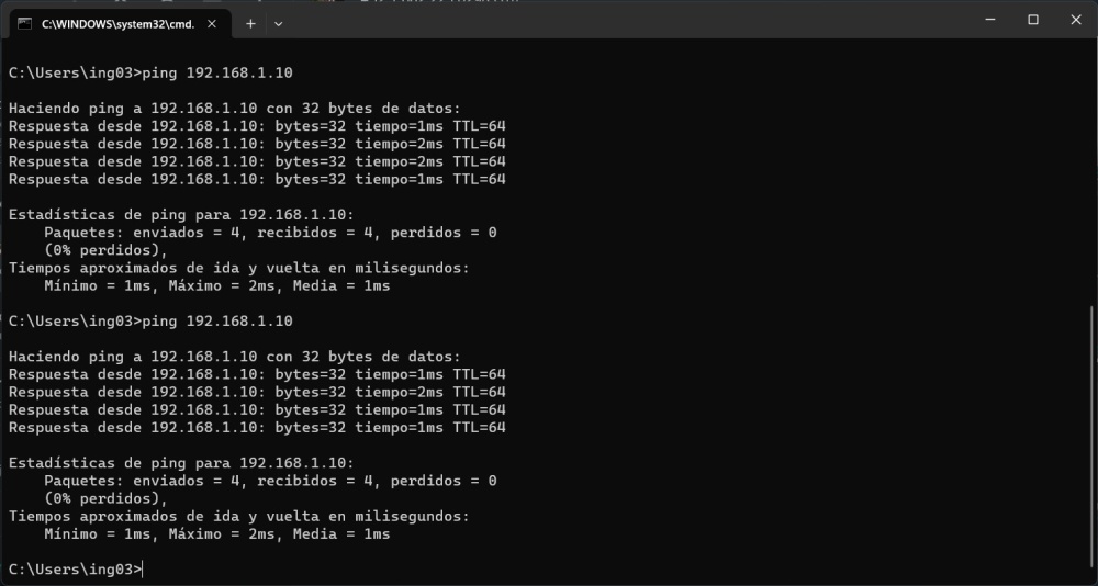

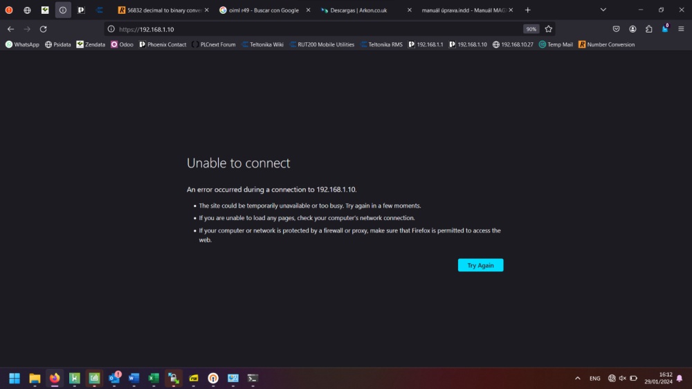

And neither no other led lights up, but when it’s ping it, responds correctly, but however through the PLCnext Engineer it is not possible to connect or go online.
