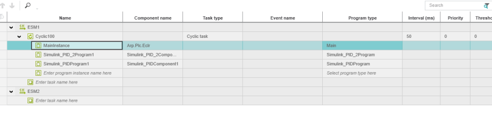

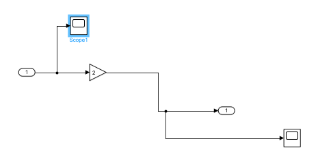

I an using PLCnext target, and i have created a basic model, I have a PWM module and i want to control the frequency for position control of motor. I want to assign the port in PWM module to input created in simulink model but i am not able to do. I would really appreciate any help.

I'm assuming your program is not instantiated under a task. Please check this point.
BR Eduard
Hi Eduard
My program is instantiated under a task.
Hi Anshuljaswal,
did you expose your ports in Matlab for GDS + Engineer?
Cheers
DivisionByZero
I did that
