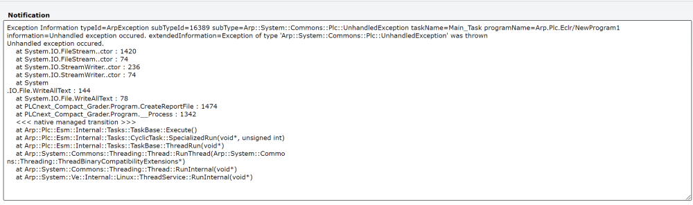

My problem though is that when I try to use "File.WriteAllText(filePath, textData);" on the paths mentioned in the previous solutions, then my plc produces an error. Maybe there is a problem with the write permissions?

I do not think they are independent, because with a valid filePath I can write to the PLC but I do not think that that filePath will be a valid path that can be stored a file to be downloaded.
I used the following filePath because this is the one that was used in the previous answer for the file to be stored to.:
public const string reportFilePath = "/projects/PCWE/Services/Ehmi/ehmi/myReport.txt"; // ../opt/plc/XXX is the base path
That provided the following error:
IF I use -> public const string reportFilePath = myReport.txt"; // ../opt/plc/XXX is the base path THEN the file is created correctly but I do not think that I can use this file path to download it afterwards.

Please try without the leading slash, which indicates that the path should start at the root of the directory tree (
), not from the current directory (/opt/plcnext/
)Alright, I feel embarrassed now, thank you Martin once again.
