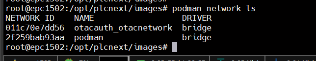

img2) However, the network is not created in AXC F 3152.
img3) When running on epc1502 to write the same app-compose.yml file, the network is created.
What's problem?
